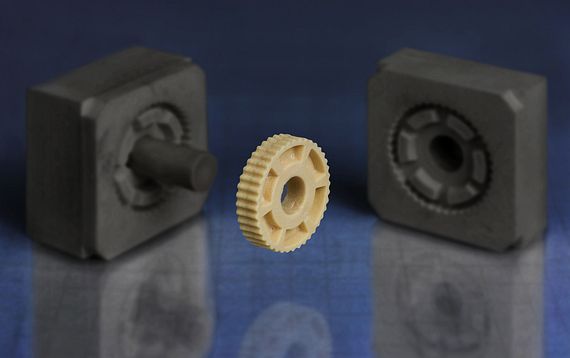

Low Volume Injection Molding from IGUS
Injection molding generally has a tremendous up-front cost for manufacturing the mold. But IGUS offers 3D printed molds made from one of their specialty polymers that significantly reduces the wear on the mold and can be used for lower volumes at lower up-front costs. The quoting process is involved, but this service may be a useful resource to keep in your back pocket.
