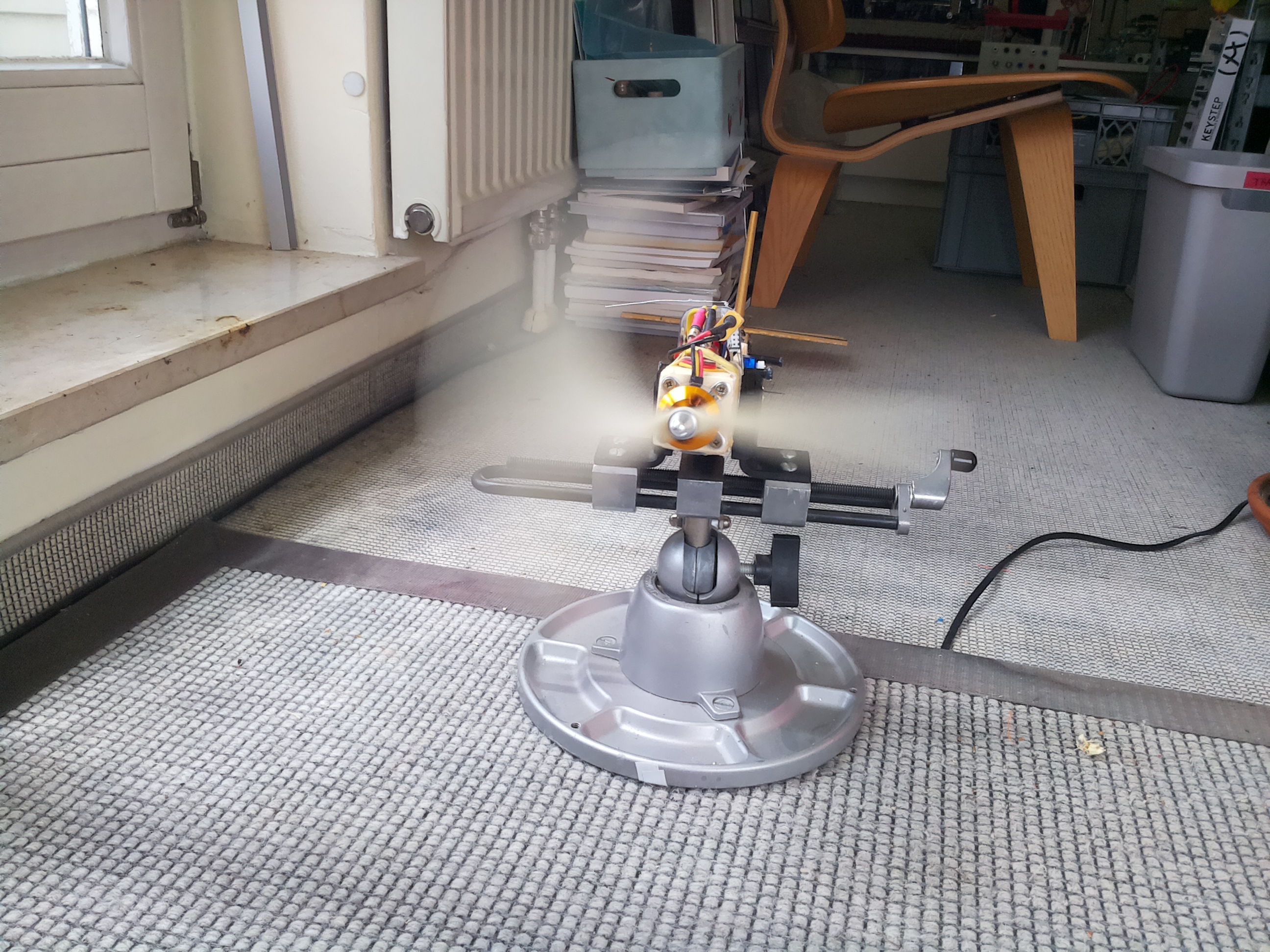

Here I’ve pulled out the classic demo: a spinning propeller. Have a look at the strange shapes that come out of the rolling shutter camera! All of the images are blurred a little bit because the blade was moving fast during the exposure; if you need to reduce the blur, more light and shorter exposure times would help. But if you want to unbend the banana, only a global shutter can save you.
Similarly, check out the video demos. As I ramp up and down the propeller speed, you can get glimpses of the shape aliasing with the cameras’ frame rates. With the global shutter, you get nice clovers, but with the rolling shutter, you get sickles and even disconnected ghost blades. Trippy.
