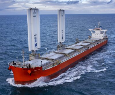

Enter the WindWings, a revolutionary “wind assisted propulsion” concept developed by BAR Technologies. In partnership with ocean freight firm Cargill, these radical sails were installed aboard the Pyxis Ocean, a Kamsarmax bulk carrier chartered from Mitsubishi. These aren’t the canvas and rope constructs of yore . Instead, they’re a set of towering metal sails that stand 123 feet tall, designed to harness the wind’s power and propel the massive bulk carrier across the oceans.
The ingenuity of the WindWings lies in their adaptability. Unlike some sail designs of old, they can pivot. This allows the vessel to make the most of the wind without unduly compromising its intended route. The sails feature built-in sensors that allow them to adjust their thrust or drag in real time. The sails significantly reduce reliance on fossil fuels. The ship’s gas engines can be throttled down when a boost from the wind is available, saving precious fuel and cutting emissions. The sails auto-adjust to prevailing conditions, and can be raised and lowered by the crew as needed.
The sails tower high above the deck when in use. They can pivot as needed to make the most of prevailing winds. Credit: BusinessWire press release
The impact of this technology is not merely theoretical. The Pyxis Ocean’s journey through the Indian, Pacific, and Atlantic Oceans from August 2023 to February 2024 showcased remarkable results. In optimal wind conditions out on a sea voyage, the savings hit 11 tonnes of fuel a day, offering a glimpse into the potential environmental benefits of widespread adoption of this technology. Overall, it’s estimated the sails could save roughly 3 tonnes of fuel per day over a year of operations. For a ship like the Pyxis Ocean, that’s roughly a 14 percent saving. As for emissions, the sails slash 11.2 tons a day of CO2 equivalent emissions on a well-t0-wake basis. That works out to around 2650 tons of CO2 a year, equivalent to removing 480 cars from the road.
With the WindWings equipped, the Pyxis Ocean is the most efficient Kamsarmax in Cargill’s fleet. Encouraged by the Pyxis Ocean’s performance, the conglomerate is exploring options to retrofit its extensive fleet with WindWings, signaling a significant shift towards sustainable shipping practices. The expectation is that further Kamsarmax vessels could run three wings, rather than two, for yet greater fuel savings.
The wings stand a full 123 feet (37.5 meters) tall. Credit: YouTube screenshot

      there are literally multiple companies providing Flettner rotor sails for cargo ships so that might not have been the best example
  13. This thing is bullshit. Does people know how strong winds are across oceans? This ship is going to loose more money and output more CO2 than normal ship just by waiting bad weather to calms down.
