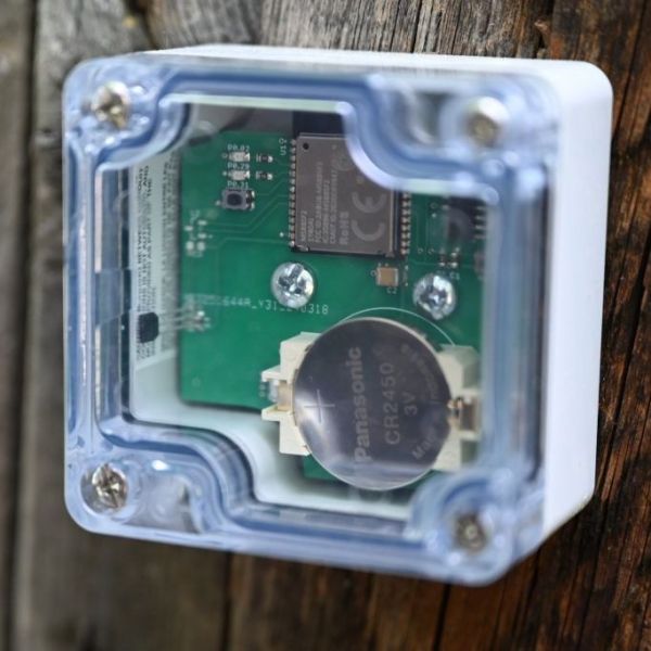

Recently [Glen Akins] reported on Bluesky that the Zigbee-based sensor he had made for his garden’s rear gate was still going strong after a Summer and Winter on the original 2450 lithium coin cell. The construction plans and design for the unit are detailed in a blog post. At the core is the MS88SF2 SoM by Minew, which features a Nordic Semiconductor nRF52840 SoC that provides the Zigbee RF feature as well as the usual MCU shenanigans.
Previously [Glen] had created a similar system that featured buttons to turn the garden lights on or off, as nobody likes stumbling blindly through a dark garden after returning home. Rather than having to fumble around for a button, the system should detect when said rear gate is opened. This would send a notification to [Glen]’s phone as well as activate the garden lights if it’s dark outside.
Although using a reed relay switch seemed like an obvious solution to replace the buttons, holding it closed turned out to require too much power. After looking at a few commercial examples, he settled for a Hall effect sensor solution with the Ti DRV5032FB in a TO-92 package.

  3. You can get reed switches that are magnet off/ closed door-open circuit. Sounds like the hall effect sensor sips power so that’s a great solution.
    1. The issue was that reading the sensor requires a pull-up resistor, so one of the logic states will always draw extra current whether it’s a normally open or a normally closed switch. The door can remain open or closed for long periods of time, so it’s possible to drain the battery by forgetting to close the door.
      Since the change in logic level is probably what drives the wake-up interrupt for the MCU, you can’t leave the logic state undefined or else it would trigger the wake-up event from random noise. I.e. you can’t use clever tricks to poll the input to detect whether the switch is open or closed without a pull-up resistor.
      The Hall sensor has a push-pull output, meaning that the logic state is always defined as either high or low, which means the MCU doesn’t need to enable its pull-up resistor on the input and there’s no variable current draw depending on the state of the switch.
