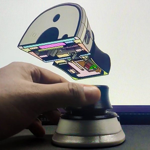

Let’s say your CAD workflow is starving for spatial awareness. Your fingers yearn to push, twist, and orbit – not just click. Enter the Nebula Mouse. A 6-DOF DIY marvel, blending 3D printing, magnets, and microcontroller wizardry into a handheld input device that emulates the revered 3DConnexion SpaceMouse – at a hacker price. It’s wireless, RGB-lit, powered by a chunky 1500 mAh cell, and fully configurable through standard apps. The catch? You print and build it yourself, with a little help of [DoTheDIY]’s design files.
This isn’t some half-baked enclosure on Thingiverse. The Nebula’s internals are crafted with the kind of precision that makes you file plastic for hours just to fit weights correctly. Hall effect sensors track real-world movement in all axes; a Seeed Xiao nRF52840 handles Bluetooth duty. It’s hefty (280 g), intentional, and smartly designed: auto-wake, USB-C, even a diffused LED bezel for night-time geek cred. Just beware that screw lengths matter. Misplace a 20 mm and you’ll hear the soft crack of PCB grief. No open firmware either – you’ll get compiled code only, unlocked per build via Discord.
In short: it’s not open source, but it is deeply open-ended. If your fingers itch after having seen the SpaceMouse teardown of last month, this might be what you’re looking for.

What exactly keeps someone from building this hardware assembly, and then putting open sourced software on it? Like porting a software solution from a different open sourced device
That will be great. If it helps, I can release the schematics so others can develop their code.
Nothing. Go on.
(Seriously, that would be great!)
Have added schematics to the plan now

I wonder what “a hacker price” is. You have to order 3 custom boards from JLC, Laser cut metal weights, source a bunch of stuff (battery, cables, custom made spring). And then you still have to pay for the firmware. (How much?)
The 3d printed parts are basically free. But I’d be surprised if you can build a single piece for less then 100€, unless you have a good Lasercutter and solder all the boards yourself.
The project page states “This is a very advance level project and build will require good problem solving skill, So only proceed if you can challenge yourself”. So I doubt it is really to safe a lot of money, more a “DIY because I can”.
Maybe if you live in India or something. But even at minimum wage, you’re probably better of doing 12 hours of work and just buying a space mouse wireless.
I’m sure, if you build 50 of these, you could sell them at 50$ with a nice margin. But single quantities are expensive.

That version from Salim will not work, with 1x 3d sensor TLV493D you cannot do 6-DOF. Making a nice video spending time on finishing/painting showing how it is made and documenting steps does not mean the product works as expected. That guy does not show for 10 seconds how the product works, how smooth is the motion, its just an marketing video. I just see people adoring the build video and not looking at the real fact that Salim has cleverly hidden that his implementation does not come anywhere close to spacemouse, He just gives a small hint on this at the end of video.
there is a reason i am using 3x TLI493 sensor which give 3×3 axis data so that 6-DOF can be calculated.
Most of the 6-DOF mouse implementations do not even come close to spacemouse like Os3m, Orbion , Implementation by Salim.
