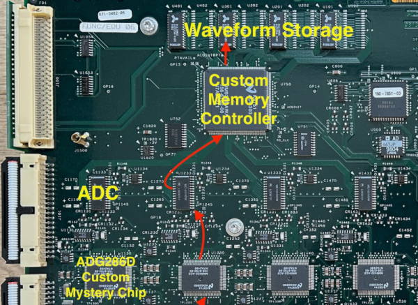

You’re designing an oscilloscope with modest storage — only 15,000 samples per channel. However, the sample rate is at 5 Gs/s, and you have to store all four channels at that speed and depth. While there is a bit of a challenge implied, this is quite doable using today’s technology. But what about in the 1990s when the Tektronix TDS 684B appeared on the market? [Tom Verbure] wondered how it was able to do such a thing. He found out, and since he wrote it up, now you can find out, too.
Inside the scope, there are two PCBs. There’s a CPU board, of course. But there’s not enough memory there to account for the scope’s capability. That much high-speed memory would have been tough in those days, anyway. The memory is actually on the analog board along with the inputs and digitizers. That should be a clue.
The secret is the ADG286D from National Semiconductor. While we can’t find any info on the chip, it appears to be an analog shift register, something all the rage at the time. These chips often appeared in audio special effect units because they could delay an analog signal easily.
In practice, the device worked by charging a capacitor to an input signal and then, using a clock, dumping each capacitor into the next one until the last capacitor produced the delayed output. Like any delay line, you could feed the output to the input and have a working memory device.
The scope would push samples into the memory at high speed. Then the CPU could shift them back out on a much slower clock. A clever design and [Tom] gives us a great glimpse inside a state-of-the-art 1990s-era scope.

    1. FISO (fast in, slow out) seems to be the magical search term. There are a few related patents from Tektronix, for example US4648072A. The switch matrix and phase shifted clocks could explain the interleaving of samples. The pattern repeating every ~195 samples could be varying RDSon of the different switching paths.
    2. I was in the advanced development group at Tek when the FISO was being developed and that was well after the 2430. The FISO part was used in Tek scopes for 30 years. And was only recently retired. It made Tek a lot of money.
