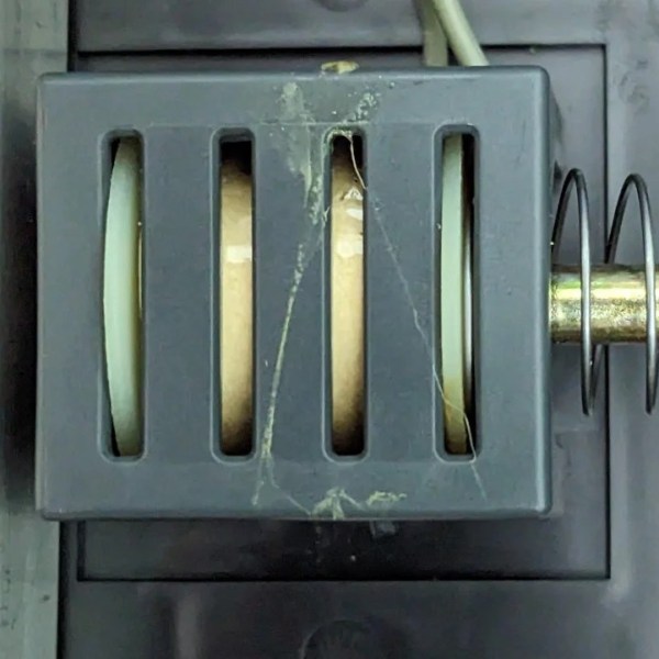

Today in the it’s-surprising-that-it-works department we have a ding dong doorbell extension from [Ajoy Raman].
What [Ajoy] wanted to do was to extend the range of his existing doorbell so that he could hear it in his workshop. His plan of attack was to buy a new wireless doorbell and then interface its transmitter with his existing doorbell. But his approach is something others might not have considered if they had have been tasked with this job, and it’s surprising to learn that it works!
What he’s done is wrap a new coil around the ding dong doorbell’s solenoid. When the solenoid activates, a small voltage is induced into the coil. This then gets run into the wireless doorbell transmitter power supply (instead of its battery) via a rectifier diode and a filter capacitor. The wireless doorbell transmitter — having also had its push-button shorted out — operates for long enough from this induced electrical pulse to transmit the signal to the receiver. To be clear: the wireless transmitter is fully powered by the pulse from the coil around the solenoid. Brilliant! Nice hack!
We weren’t sure how reliable the transmitter would be when taken out of the lab and installed in the house so we checked in with [Ajoy] to find out. It’s in production now and operating well at a distance of around 50 feet!

    1. I would rather have the pushbutton-doorbell circuit left connected as in the original circuit and sense the doorbell activation directly on the sounder. This way if the ESP or power supply stop working you still have a doorbell.
      1. That’s another option. It wouldn’t help me in my case. I didn’t have a doorbell at all and the notification that there is someone at the door with a picture from my security camera is send through telegram to my phone and audible through the google home’s. I don’t have a gong connected. So if the power supply or ESP stop working, I wouldn’t know.

    1. That would work. His wired doorbell runs off of mains voltage 220v, there is no transformer (wierd). That kinda relay is special order. He was able to pull this off with stuff everyone has in their parts bin.
