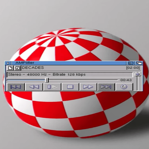

The AA3000, developed as a prototype by Commodore, was never released to the general public. Unlike the original A3000 this one would have included a digital signal processing chip from AT&T called the DSP3210 which would have greatly enhanced its audio capabilities. A few prototype boards did make it out into the hands of the public, and the retrocomputing scene has used them to develop replicas of these rare machines. [Wrangler] used one to then develop the software needed for the MPEG layer 2 and 3 decoder using this extra hardware, since the original Amiga 3000 was not powerful enough on its own to play these files back.
If you want to follow along with the community still developing for this platform there’s a form post with some more detail for this specific build (although you may need to translate from German). [Wrangler] additionally points out that there are some limitations with this implementation as well, so you likely won’t get Winamp-level performance with this system, but for the Amiga fans out there it’s an excellent expansion of this computer’s capabilities nonetheless.
    And the project page says:
    MPEG 1 Layer III files must be 96kbps or less and the frequency 32kHz (see below for how to do this)
    I’m pretty sure that if we play the game of lowering requirements, we could assume that the original Amiga 3000 was powerful enough to play MP3 files, as long as we’re talking about 8 kbps mono ;-)
        1. I’m pretty sure that I was able to play 128kbps MP3s on my A4000/040, albeit Tracker/MED/OctaMED tunes were more prevalent at the time. If I get time later today I’ll fire up WinUAE with various machine speed presets and see if my memory’s accurate.
    1. That does seem oddly weak. The DSP3210 could run 32-bit floating point algorithms generally 5-10x faster than a 68040, much less a 68030. This works via internal SRAM, zero overhead loops, MAC instructions — the usual DSP stuff — and a 50MHz CPU clock in the otherwise 25MHz system.
      I did see one of these boards but not all the details. The original project was called the Amiga3000+ at Commodore. Along with the DSP, I had a 16-bit Audio CODEC and an audio mixer so that Amiga and DSP audio could play through the same outputs, however you liked, but there was no need to go through Paula to play back audio. If they don’t have direct audio output, maybe some of the restrictions are to better map into the Amiga’s audio, but I’d want that as a transcoder on the DSP, not a file format restriction.
      We could play off the shelf 128kb/s MP3 files some years later on the Metabox Phoenix set top box prototypes. I ran a Motorola/Freescale ColdFire at 90MHz and 144MHz depending on model, with SDRAM. The ColdFire did offer MAC instructions, but no hardware floating point. On the 90MHz version that did chew up something like 90% of the CPU.

  4. So not as powerful as the 56k in the falcon which could just about manage a 320kbit mp3 in the lowest resolution that allowed to mp3 player to be usable. Amazing work and really interesting stuff I never even knew this was planned for the Amiga lineup!
    1. The DSP3210 was significantly more powerful than any 56K processor… ours could peak at around 25MFLOPS. It multitasked and did 32-bit floating point 5x-10x faster than the 68040. It also shared the main bus with the CPU (68030 or 68040), so all dram could be reached directly, not sitting out on an I/O port like the MC56K. So they have some limitations that’s not clear… Probably formatting audio to play native on the Amiga legacy hardware. I’ll probably see these guys at Amiga40 in Dusseldorf this year… I’ll want the whole story. Could be this is just the first prototype and they’ll improve it later.
      The original Amiga3000+ at Commodore has its own 16-bit Audio CODEC that could mix with legacy Paula audio… No need to transcode for playback. Just a guess. The AA3000 design these are based on was after the new Commodore management forced me to remove all the extra audio stuff in the prototypes, but I kept the improved DSP design. Sadly, a bug in the interface hardware added to the last version of the DMAC chip meant I had to hack in the interface with some dead but PALs. So we only had three DSP machines of the 50 or so AA3000 boards.
