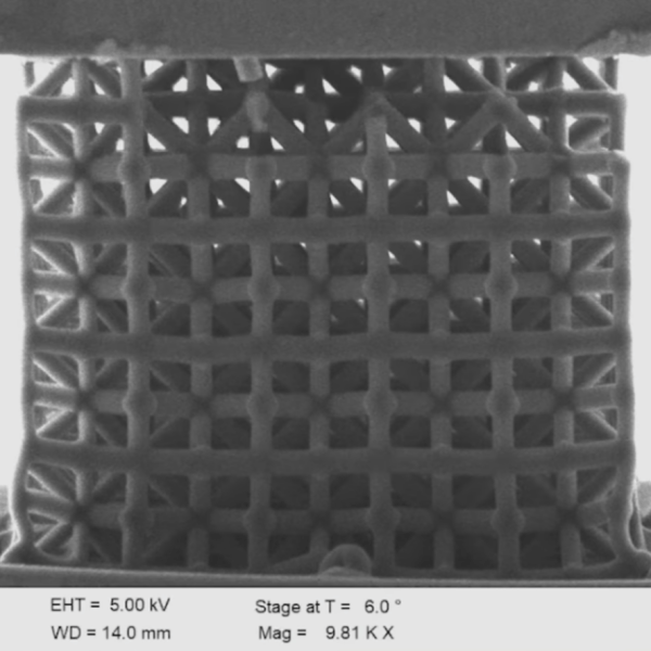

Today in material science news we have a report from [German Science Guy] about a new supermaterial which is as strong as steel and as light as Styrofoam!
A supermaterial is a type of material that possesses remarkable physical properties, often surpassing traditional materials in strength, conductivity, or other characteristics. Graphene, for example, is considered a supermaterial because it is extremely strong, lightweight, and has excellent electrical conductivity.
This new supermaterial is a carbon nanolattice which has been developed by researchers from Canada and South Korea, and it has remarkably high strength and remarkably low weight. Indeed this new material achieved the compressive strength of carbon steels (180-360 MPa) with the density of Styrofoam (125-215 kg m-3).
One very important implication of the existence of such material is that it might lead to a reduction in transport costs if the material can be used to build vehicles such as airplanes and automobiles. For airplanes we could save up to 10 gallons per pound (80 liters per kilogram) per year, where an airplane like the Airbus A380-800 weighs in at more than one million pounds.
To engineer the new material the researchers employed two methods: the Finite Element Method (FEM) and Bayesian optimization. Technically these optimized lattices are manufactured using two-photon polymerization (2PP) nanoscale additive manufacturing with pyrolysis to produce carbon nanolattices with an average strut diameter of 300 and 600 nm.

This only works for compression loads; for tensile strength, only the bulk material and cross section are relevant, as far as I know. Maybe it’s possible to combine this with a material that is very good in tension and very bad at compression, like long-chain polymers, to create an equivalent of pre-stressed concrete, that is strong in both compression and tension.
I would be worried about fatigue performance.
look into foam core composite construction, where the low compressive and tensile streangth is not a detriment, as the ability to provide a bridge between the very high strength but thin walls, prevents buckling…..an even lighter corewith high compresive strength will of course be better, but who is kidding who, it would take forever to print a 4×8 sheet and it would cost a c4azy amount of money, so its not going to happen outside of mega budget space related stuff
If anyone looks closely at the pic at the top of this article (term used very loosely) at the bottom of the photo it shows the magnification 9.81k
… Which depends on screen rendering and a host of other factors. Maybe better to look at the actual and obvious 2-micron scale bar.

The material is a carbon nanolattice. The paper is here: https://advanced.onlinelibrary.wiley.com/doi/10.1002/adma.202410651 The notes on the YouTube video are also quite extensive but some of them are in German: https://www.youtube.com/watch?v=qCf65Z2pe2Q
I have updated the article to say that the material is a carbon nanolattice.

This is a truss based lightweighting (like aerogels); unfortunately it is difficult to scale this up for larger scales (amount) and rapid manufacturing. alternative additive layer manufacturing is quite viable for hirearchical (cellular) structured materials. This can be seen in the (design) work of Prof Mike Ashby, (Cambridge UK) and, also Roderic Lakes (Wisconsin) in ultra lightweighting (Lakes gives a homage to the work of Eiffel). The book by Ashby & Gibson gives some examples of how cellular structured materials may be designed.
However the manufacture is the problem. Please see, for an example of a 2nd order structure manufacturing , in the comments in https://www.theengineer.co.uk/content/news/dmex-to-develop-advanced-defence-materials/
True that they are not great for tension but for energy absorption (directly or viscous dissipation) and stiffness and strength there are many design opportunites. I should say that I do not know if layers of graphite can be well bonded but for titanium sheet manufacturing is clear (and most likely for most metals).
But, to re-iterate there needs to be interest in manufacturing at a useful scale (eg for armout or submarines….)
Any mention of shear or tensile strength? Styrofoam itself is pretty good at compressive..
The paper covers compression and shear, no mention of tensile: https://advanced.onlinelibrary.wiley.com/doi/10.1002/adma.202410651
No mention of tensile strength, so probably very, very low. Looking at the structure, with a little compression, the lattice translates shear to compression. It can’t translate tensile forces to anything.
So they’re claiming to have invented carbon?
I was hoping to see some closeups of the rod.
Styrofoam ranges from 12 kg m3 to 33 kg m3. I don’t know where they got the density number from
Carbon-carbon covalent bonds are VERY strong and stiff. Diamond for instance. Their inherent flaw is structures employing that bond tend to be fatally brittle. (Because most engineering materials tend to be designed for a maximum strain of about 0.1%. At that strain rate, the material must be able to dissipate excess stresses without catastrophic failure.) Many supermaterials fail miserably at that crucial requirement and so they’re a bust.
