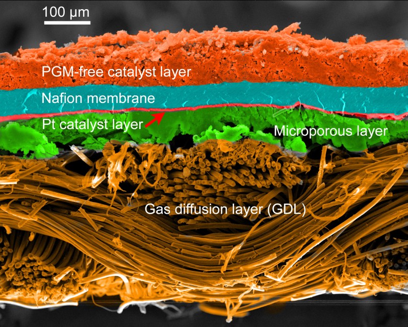

Featured image: “SEM micrograph of an MEA cross section” by [Xi Yin]

    Not mentioned in the article is that PEM fuel cells degrade as they age and due to the platinum catalysts, the exotic materials in the ion exchange membrane, and the exacting technical needs of the gas diffusion layer, they are very expensive
