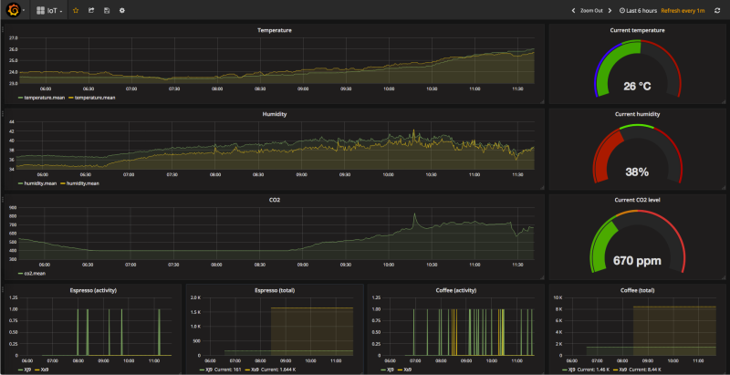

Grafana dashboard for the BMaC system.
While some of the TSDs come with their own graphing system, others rely on third-party solutions. The purpose of this graphing step is to take the raw data in the TSD and put them into a graph, a table or some other kind of visualization. When multiple of such visualizations are displayed concurrently and continuously, it’s called a ‘dashboard’, which is what software like Grafana allows you to create.
As an example of such a system, there is the Building Management and Control (BMaC) project that I created a few years ago. In addition to being able to control things like the airconditioning, the data from multiple sensors constantly get written into an InfluxDB bucket, which in the office test environment included such essentials like the number of cups of regular coffee and espresso consumed at the Jura coffee makers with their TOP-tronics brains, since this could be read out of their Flash memory.
With this visualization dashboard it’s easy to keep track of room temperature, air quality (CO2) and when to refill the beans in the coffee machines. Transforming raw data into such a dashboard is of course just one way to interpret raw data, with generating one-off graphs for e.g. inclusion in reports being another one. Which type of transformation is the right one thus depends on your needs.
