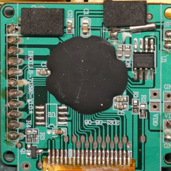

For some reason, people are really into tiny arcade machines that basically require you to ruin your hands and eyes in order to play on them. That said, unlike the fifty gazillion ‘retro consoles’ that you can buy everywhere, the particular mini arcade machine that [David Given] of [Poking Technology] obtained from AliExpress for a teardown and ROM dump seems to have custom games rather than the typical gaggle of NES games and fifty ROM hack variations of each.
After a bit of gameplay to demonstrate the various games on the very tiny machine with tiny controls and a tiny 1.8″, 160×128 ST7735 LC display, the device was disassembled. Inside is a fairly decent speaker, the IO board for the controls, and the mainboard with an epoxy blob-covered chip and the SPI EEPROM containing the software. Dumping this XOR ‘encrypted’ ROM was straightforward, revealing it to be a 4 MB, W23X32-compatible EEPROM.
Further reverse-engineering showed the CPU to be a WDT65C02-compatible chip, running at 8 MHz with 2 kB of SRAM and 8 kB of fast ROM in addition to a 24 MHz link to the SPI EEPROM, which is used heavily during rendering. [David] created a basic SDK for those who feel like writing their own software for this mini arcade system. Considering the market that these mini arcade systems exist in, you’ve got to give the manufacturer credit for creating a somewhat original take, with hardware that is relatively easy to mod and reprogram.

So, a commenter pointed me towards the Game King, which is a similar but simpler device, and from there I found this page: https://bootleggames.fandom.com/wiki/%221.8%22_Handheld_Games and from there I found that there is, indeed, MAME support for this series of devices: https://github.com/mamedev/mame/blob/master/src/mame/tvgames/st2302u_bbl_spi.cpp
But it doesn’t look like it actually functions; it looks like the skeleton only. I’ve tried to contact the author. They’re welcome to use anything I figured out. I did check the two ROM images I produced (which are illegally checked into the github repository) and the checksums don’t match anything that MAME references.
Re the manufacturer: I did find a GeneralPlus datasheet of a device which closely matches the layout of what I’m seeing; I/O ports at 0000.007f, RAM from 0080 up, ROM at 6000, probably a 6502 (GeneralPlus are very careful not to namecheck the 6502 anywhere, although some datasheets do describe the instruction set in enough detail to be sure that’s what it is). But that device, a remote control controller, has much less RAM, so it’s clearly not the same one. I didn’t know about XaviX or Elan. If you know any way to identify the chipset, I’d love to know.

Honestly, I wouldn’t be surprised if it was a VT02 chip in there. Most “NES clones with LCD” here are VT02 based. :)
https://www.nesdev.org/wiki/VTxx

Nah, it’s not a NOAC — video rendering is done in software, compositing one scanline at a time and then updating the ST7735’s external video memory. Sprite data is streamed from SPI flash on demand. It’s a completely different architecture.
