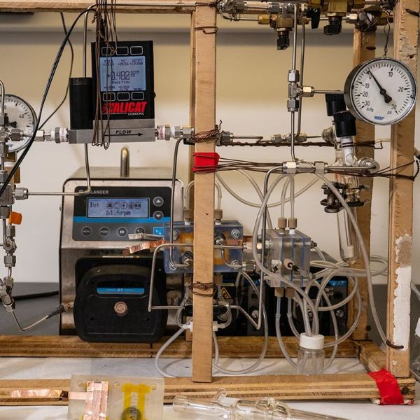

The experimental setup with the gas diffusion electrode (GDE) and the copolymerization steps. (Credit: Caltech)
The full paper as published in Angewandte Chemie International is sadly paywalled with no preprint available, but we can look at the Supplemental Information for some details. We can see for example the actual gas diffusion cell (GDE) starting on page 107 in which the copper and silver electrodes react with CO2 in a potassium bicarbonate (KHCO3) aqueous electrolyte, which produces carbon monoxide (CO) and ethylene (C2H4). These then react under influence of a palladium catalyst in the second step to form polyketones, which is already the typical way that these thermoplastics are created on an industrial scale.
The novelty here appears to be that the ethylene and CO are generated in the GDEs, which require only the input of CO2 and the potassium bicarbonate, with the CO2 recirculated for about an hour to build up high enough concentrations of CO and C2H4. Even so, the researchers note a disappointing final quality of the produced polyketones.

  4. If I’m reading the image (which is in the header) correctly then platinum, silver, and copper are expended as part of the electrocatalysis process. This system could only possibly be viable if you can reliably capture an reprocess those metals as none of them are cheap, especially platinum!
    1. They’re catalysts, which means they’re in theory unchanged during the process. They’re still all in the same place in the same amount after you’ve run it for however many hours.
      In practice, they get contaminated and eventually you have to ship them all into a refiner and get back clean catalysts, and very nearly the entirety of chemical engineering is the process of trying to extend your catalyst lifetime.
