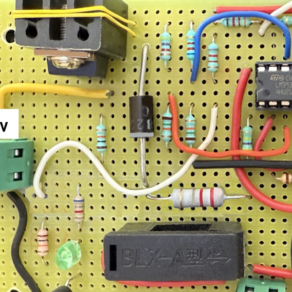

So you want a light that runs off solar power. But you don’t want it to go dark if your batteries discharge. The answer? A solar-mains hybrid lamp. You could use solar-charged batteries until they fall below a certain point and then switch to mains, but that’s not nearly cool enough. [Vijay Deshpande] shows how to make a lamp that draws only the power it needs from the mains.
The circuit uses DC operation and does not feed power back into the electric grid. It still works if the mains is down, assuming the solar power supply is still able to power the lamp. In addition, according to [Vijay], it will last up to 15 years with little maintenance.
The circuit was developed in response to an earlier project that utilized solar power to directly drive the light, when possible. If the light was off, the solar power went to waste. Also, if the mains power failed at night, no light.
The answer, of course, is to add a battery to the system and appropriate switching to drive the lights or charge the battery and only draw power from the mains when needed. Since the battery can take up the slack, it becomes easier to load balance. In periods of low sunlight, the battery provides the missing power until it can’t and then the mains supply takes over.
Comparators determine whether there is an under-voltage or over-voltage and use this information to decide whether the battery charges or if the main supply takes over. Some beefy MOSFETs take care of the switching duties. Overall, a good way to save and reuse solar cell output while still drawing from the grid when necessary.

This is quite bad honestly.
The faux BMS is really not needed (with its 0.5mA continuous drain!), SLA batteries can work well without kids gloves. The undervoltage lockout is useful though.
This entire project is begging to be replaced by a 1$ buck-boost converter and two schottky diodes.
I agree that the circuit is complicated for what it does, but as the author says, the whole overvoltage cutoff section is just a proof of concept that should be replaced with a proper MPPT solar charger.
Your simple boost-buck converter circuit might also do the job fine (after all, MPPT is basically just a buck converter with fancy control logic) but I don’t think you would want to do this with no overvoltage protection at all..
Well, if the solar panel voltage and wattage are chosen carefully, and you’re ok with slow charging, you could probably get away without any regulation, as the panel will be unable to drive the battery too high.
Otherwise, charging at too high a voltage won’t give you the excitement of a lithium thermal runaway, but it can still cause electrolysis and boiling of the electrolyte. Sealed lead acid batteries can recover from this to a certain degree, but if the pressure gets too high, they’ll start venting just like any other lead acid battery. Not usually that dangerous, but definitely not good for the battery.
Lead acid batteries are supposed to be overcharged a little bit, so they can balance the cells. Since you have no access to the stack of cells inside, the only way you can balance them is by pushing in current until all the cells are absolutely full.
With SLAs and gel batteries this results in the electrolyte boiling off, and it can’t be replaced, so the balancing charge has to be done very slowly. With SLAs there’s supposed to be a catalyst that converts hydrogen and oxygen back to water if you’re doing it slowly enough. not sure if it’s always there with all brands and makes.
If you don’t, and your cell voltages start drifting apart, then you’ll inevitably under/overcharge some of the cells anyways, and that shortens the lifespan of the battery.

https://www.analog.com/en/resources/technical-articles/ideal-diode-controller-eliminates-energy-wasting-diodes-in-power-or-ing-applications.html
Ideal diode chips can often be used as power source selector switches (OR-ing circuit).
Look at the load sharing circuit diagram (Figure 5), it’s an OR-ing circuit between a wall power adapter and two batteries, BAT1 and BAT2.
Imagine that the solar panel is BAT2. Whenever the solar panel produces the highest voltage, it is switched to the load and the rest are blocked off.
Now imagine there is a conventional diode (blocking diode) from BAT2 (solar panel) to BAT1 to charge it.
When the battery is charging, the solar panel will always present the higher voltage and the battery will remain cut off from the load. The solar panel will both power the load and charge the battery. If the solar panel output drops to the point that it can no longer supply the load, the battery will be switched in. If both the battery and the solar panel do not present enough voltage, the wall supply is switched in.
All it requires is that the load is current regulated, like a LED lamp usually is, so it can accept a variable input voltage.
And, whatever happens between the solar panel and the battery can be their own business. You can place a regulator in there that caps the charging voltage to something the battery can tolerate, and implement a low-voltage cutoff circuit if you wish. If not, just match the maximum voltage and V-I curve (mind the blocking diode) of the solar cell to your battery and bob’s your uncle.
Of course, Analog parts can be mighty expensive, but the same principles apply. You just have to mind whatever hysteresis or other peculiarities the chip has: sometimes with some chips, if the two source voltages are too close to each other for too long, they both switch off.
