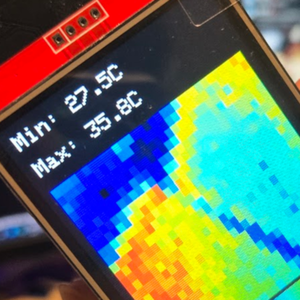

If you want to save a little money on a thermal camera, or if you just enjoy making your own, you should have a look at [Evan Yu’s] GitHub repository, which has a well thought out project built around the MLX90640 and an ESP32. The cost is well under $100. You can watch it do its thing in the video below.
There’s a PCB layout, a 3D-printed case, and — of course — all the firmware files. The code uses the Arduino IDE and libraries. It leverages off-the-shelf libraries for the display and the image sensor.
The image sensor isn’t going to wow you. It has a resolution of 24 x 32, although that’s better than some cheap cameras, and it can still honestly be good for “what part is heating up” explorations. There is probably room for some clever smoothing in software as well. For only three or four times the price, you can find cameras with resolutions around 256×192, which is good for a thermal camera, even though it isn’t the megapixels we expect from our optical cameras or our phones.
The bill of materials is relatively short. The bulk of the circuit and effort is in the circuit to charge the battery, regulate it, and protect it against bad behavior.

Current crop of Chinese thermal cam have a way higher resolution than that (256×192 or more) for a lower or similar price. But for sure it´s closed source, and the sensor they use have no marking. I´d really like to find what exact sensor they used, and a leaked datasheet even in Chinese. The problem with the firmware used with those sensors is that recalibration occurs way too often, resulting i a frame freeze of almost one second. Not THAT terrible, but i´m sure with some software optimization and frame caching it´s possible to do better than that…

A lot of those cheap cameras are just upscaling the image. Watch out for any mention of TISR, X3 or super resolution. That means the IR sensor is only half of the advertised resolution.

The board could use a revision of the layout, though. The point of GND vias is not to allow for GND pour on all of the surface, but to facilitate return path when you switch layers.
