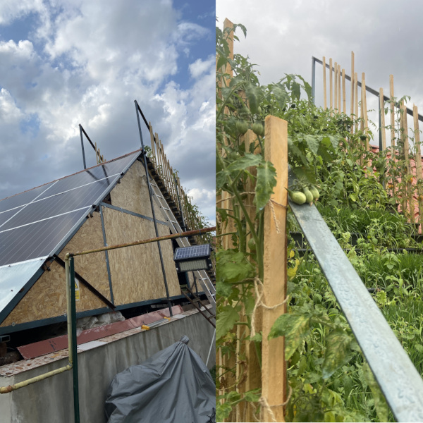

One of the biggest downsides of installing solar panels on a rooftop is that maintenance of the actual roof structure becomes much more difficult with solar panels in the way. But for many people who don’t have huge tracts of land, a roof is wasted space where something useful could otherwise go. [Mihai] had the idea of simply eliminating traditional roofing materials altogether and made half of this roof out of solar panels directly, with the other half being put to use as a garden.
Normally solar panels are installed on top of a roof, whether it’s metal or asphalt shingles or some other material, allowing the roof to perform its normal job of keeping weather out of the house while the solar panels can focus on energy generation. In this roof [Mihai] skips this step, having the solar panels pull double duty as roof material and energy generation. In a way this simplifies things; there’s less to maintain and presumably any problems with the roof can be solved by swapping out panels. But we would also presume that waterproofing it might be marginally more difficult.
On the antisolar side of the roof, however, [Mihai] foregoes the solar panels in favor of a system that can hold soil for small garden plants. Putting solar panels on this side of the roof wouldn’t generate as much energy but the area can still be useful as a garden. Of course we’d advise caution when working on a garden at height, but at least for the solar panels you can save some trips up a ladder for maintenance by using something like this robotic solar panel scrubber.

Have you considered following the links the article gave? A bunch of pictures are on the github page…
https://github.com/f-roof/.github/tree/main/pictures
As for the waterproofing, thought was put into it, but it doesn’t look very robust.

Here is a new movie during a heavy rain:
https://www.youtube.com/watch?v=0JjJXp-amts
As you can see, there is no water inside.
How about under the solar panels.
That’s the terracing.
Which isn’t leaking, yet.
How much slope on the flat part of the plant terraces?
Going to want at least a bubble, assuming it freezes at some time during the year.
I would also want some overhang on the ends and bottom.
It’s often windy along with rain here.
Also: how much aluminum in that roof?
Roughly (e.g. ‘roof is aluminum sheet folded down terrace steps’ or ‘just flashing’).
Thanks.

There is “proper” tray solar and that works the same way. It’s now the normal way solar is put into new roofs in the UK and also when solar is added during a re-roofing of an older property as it’s usually cheaper.
There are some distinct disadvantages though – having solar as your roof reduces the amount of cooling on the panels a lot (not a big deal most of the year here), and also stops them acting as parasols keeping the worst of the suns heat off the true roof and the rooms below. So “on roof” solar still outperforms it somewhat but costs a lot more.
My house is half-buried in the ground, so during summer is cold inside and during winter is not very cold. Also, I plan to remove the excess heat using some vents at the top of the roof.
I have used bituminous tape for the garden part and silicon for the solar panels part.
Pictures with inside the roof are here:
https://github.com/f-roof/.github/blob/main/pictures/IMG_3316.JPG

That doesn’t look like anywhere that a building inspector is required.
Also, with a high wind some neighbor will be cleaning up broken solar panels from their garden.
You mean more than usual installation ?
The solar panels are well connected inside the roof.
Here is a picture:
https://github.com/f-roof/.github/blob/main/pictures/IMG_3358.JPEG
Also, I tried to remove one of them because initially I have incorrectly applied silicon, but I simply could not remove it!
Replacing a broken solar panel from roof could be a serious problem! I currently do not know how I’ll handle that situation if arrises!
The link contains a video where you can see some of the info you want.
To summarize: the “building” is open to the air. I think it was made specifically as a solar array first, and perhaps a toolshed second. It is not waterproof.
Yes, I built the solar part first (in 2024) and in 2025 I built the garden.
I would love to get a structural engineer’s take on this. I stopped being able to take this project seriously when I read “Wood should not be utilized for construction purposes. Trees are more important than for building houses!” He specifies it uses “tubes” and that it’s mostly made of “metal” but never actually specifies which type of metal. It’s probably steel but there are many different variants of steel with different properties. When you are building something, it matters which type of steel you use.
There is a good chance this is a deathtrap in the making.

Looks like theirs was steel tubing which is commonly used for carports. Truth be told, it’s stronger than CFS which is often used for framing houses. One of the terrible trade offs of steel is thermal bridging though. I could see this being something like with prepackaged roof panels like they do with structural SIP. Where the solar panels provide structural rigidity with a water proofing layer underneath. You’d need some type of air channel to dry it out though.
There is no need for a layer behind. Silicon between panels is enough!
I utilized S235JRG2 steel.
Nice to see panels as roofing being done. I have seen it offered commercially in the UK before, and a quick google search came up with this company https://www.bmigroup.com/uk/solar-range/ There are probably several integrating the panels into tile and slate roofing.
That is way to go, but you must be careful with isolation between panels. Initially I applied silicon in the wrong way and I had water leakage inside roof. Then I fixed the problem using a bituminous tape placed over the silicon!

I purchased very good solar panels that have 25 years warranty for energy production. So, definitively the mechanical part will survive even more!
Also, I did NOT utilized asphalt. I do not know how this idea was connected to my roof.
bitumen and asphalt are the same.
ok, but I utilized (75mm wide) bituminous tape, which has 1mm thick layer of bitumen … and I did not placed it everywhere … only between 2 consecutive gutters.
Yeah, not how you waterproof or use non galvanized steel in exterior locations. I would estimate 3-7 years before the wood rots, collapses, and needs a complete rebuild.
I painted the steel with good paint … also all screws and nuts are from stainless steel.
