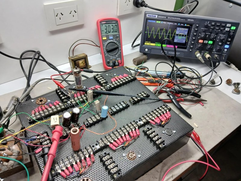

One approach is to build yourself a breadboard for tubes, like [MarceloG19] has done. Working mostly with what was laying around, [MarceloG19] built a shallow metal box to serve as a platform for a variety of tube sockets and screw terminals. Connecting the terminals to the socket leads beneath the outer surface of the box made for a tidy and firm base on which to connect other components. The built-in on/off switch, fuse and power socket are a nice touch.
[MarceloG19’s] inaugural design is a simple Class A amplifier, tested with a sine wave and recorded music. Then it’s on to some manual curve tracing, to test a tube that turns out to be fairly worn-out but serviceable for certain use cases.
If you’re dipping your toes into tube-based electronics, you’re going to want a piece of equipment like this prototyping board and [MarceloG19’s] documentation and discussion are a good read to help get you started.

My approach was to take cut leads from diodes that were either used in projects or no longer identifiable and solder those unto Sockets. These could be bent to fit in a regular breadboard. It isn’t remotely elegant or proper, but it is good enough for experiments like running tubes at lower than intended voltages and so called “Hybrid” amplifier circuits.

I am, and that’s why mine was made with an old wooden clipboard. Banana jacks for power input, several terminal blocks, a long solid copper bus bar (for tack soldering to), and octal relay sockets with screw terminals.
I just use tagboard
i have something similar. in general I’ll avoid metal for the base I’ll prefer something more ‘isolated’ (i had one made with wood probably plexiglass would be better)

Probably better than metal. Vacuum tube (9 pin) prototyping board enclosure by simplyflipflops – Thingiverse https://share.google/kndBfJvHosC5bSKJ7
