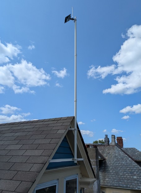

You see, at this point I had convinced myself that the reason I wasn’t getting any results back at home was the relatively meager antenna built into the Hacker Pager. Now that I had a proper node with an antenna bigger than my pinkie finger, I was sure I’d get better results. Especially since I’d be placing the radio even higher this time — with a military surplus fiberglass mast clamped into the old TV antenna mount on my three story house, the node would be around 40 feet (12 m) above the ground.
The mast gets my node above the neighbor’s roofs, but just barely.
But when I opened the Meshtastic app the day after getting my home node installed, I was greeted with….nothing. Not a single node was detected in a 24 hour period. This seemed very odd given my experience down the shore, but I brushed it off. After all, Meshtastic nodes only occasionally announce their presence when they aren’t actively transmitting.
Undaunted, I made plans with a nearby friend to install a node at his place. His home is just 1.2 miles (1.9 km) from mine, and given the casual 6 mile (9 km) contact I had made at my parent’s place, it seemed like this would be an easy first leg of our fledgling network.
Yet when we stood up a temporary node in his front yard, messages between it and my house were only occasionally making it through. Worse, the signal strength displayed in the application was abysmal. It was clear that, even at such a short range, an intermediary node would be necessary to get our homes reliably connected.
At this point, I was feeling pretty dejected. The incredible results I got when using Meshtastic in the sticks had clearly given me a false sense of what the technology was capable of in an urban environment. To make matters even worse, some further investigation found that my house was about the worst possible place to try and mount a node.
For one thing, until I bothered to look it up, I never realized my house was located in a small valley. According to online line-of-sight tools, I’m essentially at the bottom of a bowl. As if that wasn’t bad enough, I noted that the Meshtastic application was showing an inordinate number of bad packets. After consulting with those more experienced with the project, I now know this to be an indicator of a noisy RF environment. Which may also explain the exceptionally poor reception I get when trying to fly my FPV drone around the neighborhood, but that’s a story for another day.
