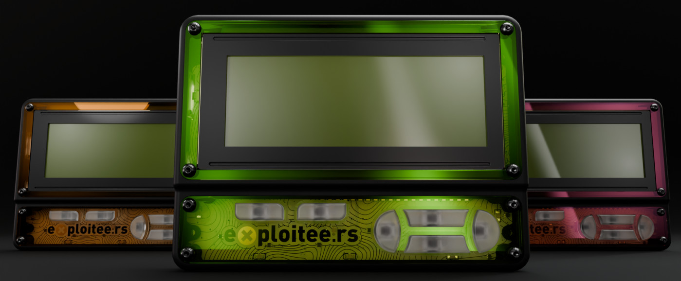

Enter the Hacker Pager from exploitee.rs. As the name implies, it’s still very much a device intended for hackers — a piece of hardware designed for the halls of DEF CON rather than trekking through the wilderness. But it’s also an important step towards a new generation of Meshtastic hardware that meets the high standard of quality set by the software itself.

Now, what makes the Hacker Pager different is that it not only works as gateway device to provide access to the Meshtastic network to a tethered smartphone, but it can also be used as a stand-alone communicator. This approach is truly the best of both worlds, as you get all the functionality of the smartphone application, while also giving you the freedom to subtract the phone from the equation entirely.
The Hacker Pager isn’t the first Meshtastic device to provide this capability, but at the time of this writing, it’s still one of only a handful of options that offer it. It is however the first one to come in the classic pager form factor, which brings with it a certain nostalgic appeal. The unique layout and interface of the Hacker Pager does come at a cost though; at least for now, it can’t run the mainline Meshtastic firmware and has its own independent fork. But we’ll get back to that in a minute.

The firmware for the Hacker Pager is forked from the upstream Meshtastic project, and as such, the device is fully compatible with all the infrastructure that’s already out there. Similarly, when used in conjunction with the official Meshtastic smartphone application, you’ll have all the features and functions you’re used to. But when you use the Hacker Pager on its own, it’s unlike any other Meshtastic device out there.
That’s largely due to the fact that the retro-inspired hardware of the Hacker Pager demands a different sort of user interface than any of the existing Meshtastic devices. The menu system makes excellent use of the vibrant 192×64 pixel monochrome LCD, and banging out messages using the on-screen keyboard and directional buttons is a breeze. Users from the younger generations may need some time to adapt, but for those of a certain age, it feels like home.
One of my favorite features doesn’t even kick in until you’ve put the Hacker Pager down for a bit. Once the device has hit the user-defined idle timeout, the screen backlight turns off and the screen shifts over to an ambient clock display that also shows critical status information such as battery level, number of nodes in the area, and a new message indicator.
It’s also got the features you’d expect from a modernized pager. You can be notified of incoming messages by the classic audible alert or vibration, naturally. But there’s also 36 addressable RGB LEDs and a dozen UV LEDs that are more than happy to put on a light show each time something hits your inbox.
