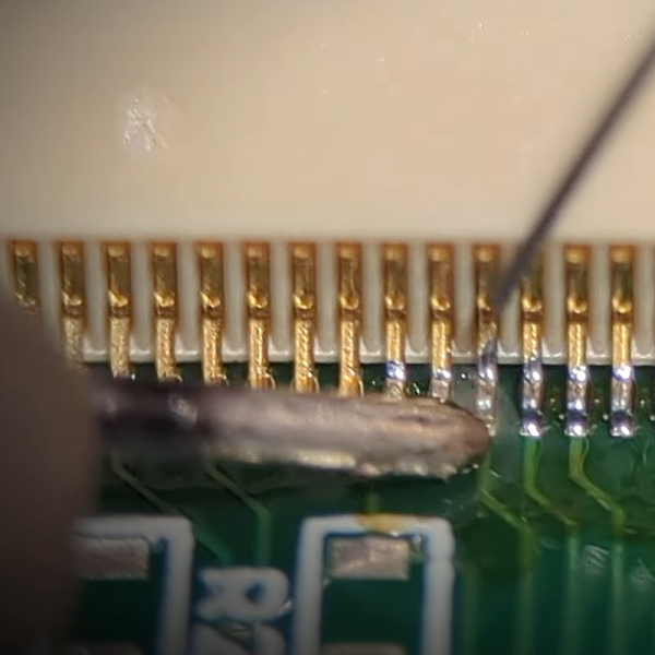

You have some fine pitch soldering to do, but all you have on hand is a big soldering iron. What do you do? There are a few possible answers, but [Mr SolderFix] likes to pull a strand from a large wire, file the point down, and coil it around the soldering iron. This gives you a very tiny hot tip. Sure, the wire won’t last forever, but who cares? When it gives up, you can simply make another one.
Many people have done things like this before — we are guilty — but we really liked [Mr Solder Fix’s] presentation over two videos that you can see below. He coils his wire over a form. In his case, he’s using a screwdriver handle and some tape to get to the right size. We’ve been known to use the shanks of drill bits for that purpose, since it is easy to get different sizes.
Truthfully, while sometimes you do really need a tiny tip, we prefer having a tip with some thermal mass. If you use something shaped like a slotted screwdriver blade, you can get contact area when you need it, or rotate the iron 90 degrees and get a very narrow profile.
But the copper coil method does work well, as you can see. This will work with nearly any iron. The first examples with fairly large resistors work predictably well. But we were really impressed with some of the very fine pitch connectors in part 2.
Of course, a fine tip is only part of the equation. It doesn’t hurt that he has a microscope and thin solder. If you want to up your SMD game, Oregon State University can help. We find it amusing that many products today are smaller than the components we used to use.

I tried this some 30 years ago and it does work, but it does not last. The copper dissolves into the solder and the tip looses it’s shape quite quickly. I forgot how long it lasted but probably somewhere between 10 minutes and half an hour. But still, that is enough for “emergency situations” or occasional use. If you’re soldering more, you’re likely to already have better equipment and a bunch of tips in different sizes.

I too have never used a fine tip. If your tip is too fine, then the heat dose not transfer well. My soldering iron tip only gets changed when it wears out, and I’ve been commercially assembling SMT boards for the last 30+ years. It is a bit of a mistake to use a very fine tip in my opinion. The secret is good thermal transfer and FLUX!
Yeah, pictures of fine pitch parts with huge amounts of space around them are exactly the sort of situation that inexperienced solderers think require fine tips when it’s actually the reverse.
The only time you really need a truly fine tip is when you physically can’t get a blunt tip to reach – so boards with high density part placement or awkward tall packages right next to each other where there’s little to no room between them.
Can be handy to deal with that one or two fiddly bridged pin/pads in the fine stuff even when you have decent access – the big tip just remelts too large a zone and gets in the way of applying the fresh solder so actually removing the excess and/or bringing in the right amount of new solder in the right place is just not as easy – though definitely possible with the larger tip still. Also depends on just how large your standard tip is – my iron is pretty old with a default tip size that is actually quite huge compared to the seemingly most common size now (but the smallest tip my iron has is closer if still large).

A bent bevel tip ~2mm cover 99.9% of all smd. It’s rare to need anything smaller as long as it’s clean and has a corner.
Sadly this post/video gives bad, perhaps outdated advice? It teaches doing things slowly and inefficiently.
This specific knowledge that small things should be soldered with small tips seems to be old as time, universal and bad. Its the source of all the cheap Chinese soldering irons bundled with useless needle shaped sharp conical tips. Small tip means minimal surface for heat transfer ending in struggles and bad joints.
As other commenters already pointed out big flat chisel tip is all you need provided understanding of solder (all liquids) physics (Marangoni effect) and flux. Like in metal welding Solder doesnt randomly flow in all directions, and once you learn what to expect you can direct it with heat, flux and simple decisive moves of the iron.
tldr without being a smart ass: Big tip + flux = excess solder will flow towards the tip while big contact surface of the tip ensures proper heat transfer for healthy joint.
