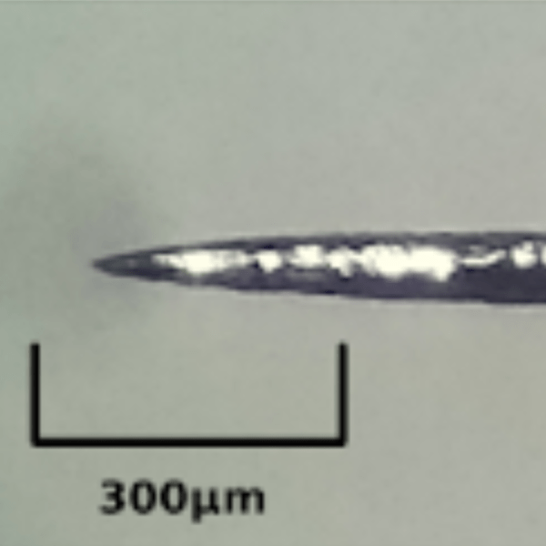

A metal needle tip comes to a point against a white background. A scale bar in the lower left shows a 300 micrometer length.
[Vik Olliver] has been extending the lower resolution limits of 3D printers with the RepRapMicron project, which aims to print structures with a feature size of ten micrometers. A molten plastic extruder would be impractical at such small scales, even if a hobbyist could manufacture one small enough, so instead [Vik]’s working on a system that uses a very fine needle point to place tiny droplets of UV resin on a substrate. These points have to be sharper than anything readily available, so his latest experiments have focused on electrochemically etching his own needles.
The needles start with a fine wire, which a 3D-printed bracket holds hanging down into a beaker of electrolyte, where another electrode is located. By applying a few volts across the circuit, with the wire acting as an anode, electrochemical erosion eventually wears through the wire and it drops off, leaving an atomically sharp point. Titanium wire performs best, but Nichrome and stainless steel also work. Copper wire doesn’t work, and by extension, nor does the plated copper wire sometimes sold as “stainless steel” by sketchy online merchants.
The electrolyte was made from either a 5% sodium chloride solution or 1% nitric acid. The salt solution produced a very thin, fine point, but also produced a cloudy suspension of metal hydroxides around the wire, which made it hard to tell when the wire had broken off. The goal of nitric acid was to prevent hydroxide formation; it produced a shorter, blunter tip with a pitted shaft, but it simply etched the tip of the wire to a point, with the rest of the wire never dropping off. Some experimentation revealed that a mixture of the two electrolyte solutions struck a good balance which etched fine points like the pure salt solution, but also avoided cloudy precipitates.

    1. Technically everything is atomically sharp. Even a steel ball, it ends up in a single atom whatever your contact point. As usual, it’s pure marketing bullshit, since we don’t actually need (and can’t use) a single atom to hold a drop of resin anyway.
    2. The funny part is, I can see the tip isn’t ‘atomically’ sharp. Its multiple pixels wide. Still an interesting article and the technique is probably really valuable for some niche applications. A little more skepticism would go a long way on hackaday lately.
      1. Slight misunderstanding: the probe image in this article is the best practical type that’s made for current hardware. The linked entry shows finer tips, far below the resolution of the crapcam on the 100x trinocular microscope. Unfortunately the higher magnification (2,400x) microscope is not camera compatible at that magnification. It shows the finest points to be beyond its resolution and still tapering.

    1. It is, actually. There are some very famous photos of the tips of tungsten needles, created using emission micrographs.
      The usual way is to use a tungsten wire, mounted on a balanced arm. The arm is balanced so that the needle just dips into a beaker of electrolyte, which if memory serves is sodium hydroxide. The needle dips into the electrolyte, completing the etching circuit, but also a small electromagnet that pulls the arm the other way. This breaks the circuit, which .. you get the idea. Because the tip of the wire spends more time in etching, a point develops.
      There’s probably a fair amount of experimentation to get the solution concentration correct, etc. etc.
      This technique is well known in electron microscopy circles, and also used for making very fine microprobes for semiconductor probing.

    1. Did that. The tip does different thing when you move it in different directions, isn’t as sharp as an etched one, and the pointy end goes off at an angle. I switched to hypodermic needles as I have a bountiful supply, then the eched wires to get a uniform point.
