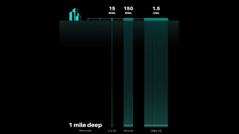

Deep Fission Wants To Put Nuclear Reactors Deep Underground
Today’s pressurized water reactors (PWRs) are marvels of nuclear fission technology that enable gigawatt-scale power stations in a very compact space. Though they are extremely safe, with only the TMI-2 accident releasing a negligible amount of radioactive isotopes into the environment per the NRC, the company Deep Fission reckons that they can make PWRs even safer by stuffing them into a 1 mile (1.6 km) deep borehole.
Their proposed DB-PWR design is currently in pre-application review at the NRC where their whitepaper and 2025-era regulatory engagement plan can be found as well. It appears that this year they renamed the reactor to Deep Fission Borehole Reactor 1 (DFBR-1). In each 30″ (76.2 cm) borehole a single 45 MWt DFBR-1 microreactor will be installed, with most of the primary loop contained within the reactor module.
As for the rationale for all of this, at the suggested depth the pressure would be equivalent to that inside the PWR, with in addition a column of water between it and the surface, which is claimed to provide a lot of safety and also negates the need for a concrete containment structure and similar PWR safety features. Of course, with the steam generator located at the bottom of the borehole, said steam has to be brought up all the way to the surface to generate a projected 15 MWe via the steam turbine, and there are also sampling tubes travelling all the way down to the primary loop in addition to ropes to haul the thing back up for replacing the standard LEU PWR fuel rods.
Whether this level of outside-the-box-thinking is a genius or absolutely daft idea remains to be seen, with it so far making inroads in the DoE’s advanced reactor program. The company targets having its first reactor online by 2026. Among its competition are projects like TerraPower’s Natrium which are already under construction and offer much more power per reactor, along with Natrium in particular also providing built-in grid-level storage.
One thing is definitely for certain, and that is that the commercial power sector in the US has stopped being mind-numbingly boring.

  1. Pumping water and steam up and down a borehole with a running reactor at the bottom sounds like a good way to create lots of radioactively contaminated water and leak it into the ground water table very effectively.
    1. You mean, like Radium in basalt? There’s no radioactive water. You can have water contaminated with radioactive elements (and even this isn’t clear, many elements are perfectly safe and radioactive). The radioactivity by itself isn’t bad. Some elements like heavy metals are bad even when not radioactive. The radioactivity is a pain because it can change a bio-safe element into a bio-unsafe element.
      1. Yeah, burying our toxic waste has always worked out so well…
        A mile underground may be ‘safe’, until something goes wrong. Difficult to inspect and maintain at that depth. Still need a means to monitor and control. Some pretty long cables. Not everywhere is entirely earthquake proof either. We only hear about the bad ones, we feel… High pressure, and a mile long bore for a rifle barrel. If it does rupture, it’ll shoot stuff a long way. Not well contained…
        Not exactly a huge amount of power from each hole either. They’ll want to do thousands of them. Why can’t we just focus on getting fusion working?
        1. That’s why actual deep borehole disposal is at least 3 miles deep, so when the containers inevitably degrade there’s enough stuff piled on top that it takes a million years to leak out – by which time it won’t be very radioactive any longer because all the nastiest stuff has decayed out.
          1. Borehole disposal is not anywhere close to operational. Its based on a lot of speculations and assumptions. Not somewhere id stick high activity waste.

  2. Since they will need to bore the holes anyway : build the concrete containment structure, for added safety, and install the steam generator down there also. Bring only the power cables to the surface. Easier to fix a broken cable than a tube leaking very hot water.
    1. That was my first thought as well; but then I wondered if the volume occupied by the alternators might be a large percentage of the area occupied by a nuclear plant. So I asked ChatGPT, which summarized the answer:
      “Only about 0.01%–0.2% of a nuclear plant’s occupied land area is devoted to the alternators themselves, even if you count the entire turbine hall.”
      I imagine that underground the percentage might be higher because there probably wouldn’t be as much need for things like the exclusion zones, support buildings, parking, etc that ChatGPT mentions.
      That suggests to me that allowing 10% of the floor area for alternators is generous. If that’s the case, then yes, generating electricity directly beside the reactor instead of on the surface seems the best way to proceed.
      But maybe keeping the alternators sufficiently cool would be a problem? Then again, THAT heat could be piped to the surface and perhaps used. So I’d be very interested to hear compelling arguments against putting the alternators underground.

    1. Boring holes. This is a hack of a nuclear industrialists, easy doable. You need only boring machine and suitable nuclear reactor type “all in one pipe” :)
  4. PWRs aren’t exactly modern tech. And the pressurised part is a huge part of the risk. They also require a ton of maintenance and care to operate.
    A more modern design with passive safety and simpler operation makes more sense if you’re putting it underground.
    And why so deep? That’s just a huge added cost, really only there to ally the fears of NIMBYs.
    1. Like having an electric car and going on a diesel powered vegan cruise. As long as the smoke is elsewhere the smug feels snug at home.
  5. A deep and narrow hole, filled with water, with a nuclear reactor core at the bottom (pulled up for servicing by ropes no less).
    I can imagine a few risk scenarios that involve that beast shooting out of the hole like a gas-propelled gerbil.
  6. Those peddling such design as “safe” should have no problems building their house over it AND living there with their families. Am I right or am I right?

  8. Have worked in the petroleum industry drilling holes this deep. Not gonna rule out those bastards making daft things work, but the idea is daft. The holes and anything at the bottom of them need routine maintenance and interact with (usually very salty) groundwater. Rock is crumbly and imperfect, especially under high pressure.
  9. Im not understanding something here. 1. Why is it necessary to go that deep? Ground level reactors dont require that much shielding. 2. If the primary steam loop and all that is above ground, why is it that much safer? In other words what problem are we solving that mitigates the crazy maintenance and surveillance process. Also, what does a refueling cycle look like?
