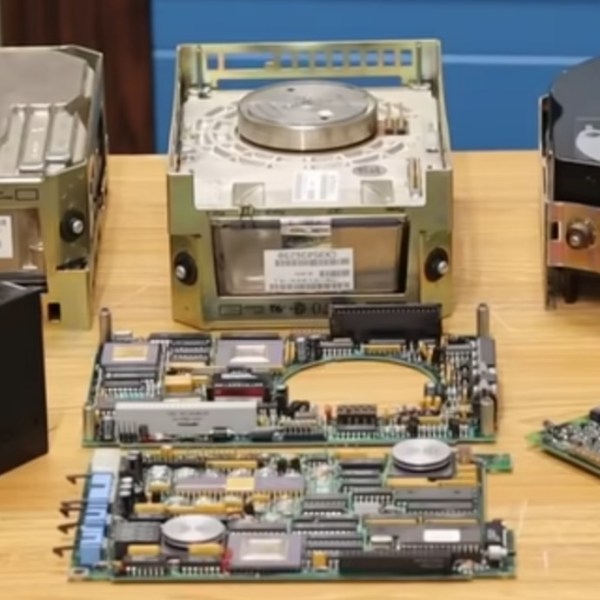

Over on YouTube [Usagi Electric] shows us how he installed an 84MB hard drive into his PDP-11/44.
In the beginning he purchased a bunch of RA70 and RA72 drives and board sets but none of them worked. As there are no schematics it’s very difficult to figure out how they’re broken and how to troubleshoot them.
Fortunately his friend sent him an “unhealthy” Memorex 214 84MB hard drive, also known as a Fujitsu 2312. The best thing about this hard drive is that it comes complete with a 400 page manual which includes the full theory of operation and a full set of schematics. Score!
After removing the fan and popping the lid we see this Fujitsu 2312 is chock-full of 7400 series logic. For power this drive needs 24 volts at 6 amps, 5 volts at 4.5 amps, and -12 volts at 4 amps. Fitting the drive into the PDP-11 rack requires a little mechanical adjustment but after making some alterations the hard drive and a TU58 tape drive fit in their allotted 3U rack space.
After a little bit of fiddling with the drive controller board the Control Status Register (RKCS1) reads 000200, which indicates fully functional status. At this point the belief is that this computer would boot off this drive, if only it contained an operating system. The operating system for this machine is RSX11. And that, dear reader, is where we are now. Does anyone have a copy of RSX11 and a suggestion for how we get it copied onto the Fujitsu 2312? We wouldn’t want to have to toggle-in our operating system each time we boot…

Anyone here have idea about what the round metallic part are doing on top of chips on the cards? Are these heatsink ?!
Just lids, before everything was fully encased in a uniform package
#TIL
What this package called?
