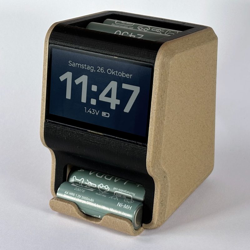

The increasing dominance of lithium cells in the market place leave our trusty NiMH cells in a rough spot. Sure, you can still get a chargers for the AAs in your life, but it’s old tech and not particularly stylish. That’s where [Maximilian Kern] comes in, whose SPINC project was recently featured in IEEE Spectrum— so you know it has to be good.
With the high-resolution LCD, the styling of this device reminds us a little bit of the Pi-Mac-Nano— and anything that makes you think of a classic Macintosh gets automatic style points. There’s something reminiscent of an ammunition clip in the way batteries are fed into the top and let out the bottom of the machine.
[Maximilian] thought of the, ah, less-detail-oriented amongst us with this one, as the dedicated charging IC he chose (why reinvent the wheel?) is connected to an H-bridge to allow the charger to be agnostic as to orientation. That’s a nice touch. An internal servo grabs each battery in turn to stick into the charging circuit, and deposits it into the bottom of the device once it is charged. The LCD screen lets you monitor the status of the battery as it charges, while doubling as a handy desk clock (that’s where the RP2040 comes in). It is, of course powered by a USB-C port as all things are these days, but [Maximilian] is just drawing from the 5V line instead of making proper use of USB-C Power Delivery. (An earlier draft of this article asserted incorrectly that the device used USB-C-PD.) Fast-charging upto 1A is enabled, but you might want to go slower to keep your cells lasting as long as possible. Firmware, gerbers and STLs are available on GitHub under a GPL-3.0 license– so if you’re still using NiCads or want to bring this design into the glorious lithium future, you can consider yourself welcome to.

Correction: this doesn’t use USB Power Delivery, just a USB Type-C port. The CC lines are just pulled to ground with 5.1 kΩ resistors.
Which is, er, not great? 1.2 W is more than some old-fashioned USB ports can provide, as a unit load is only 100 mA at 5 V, but I see nothing to indicate that it checks if it can take at least 3 unit loads. A non-enumerating option would be to hook up an ADC to the CC lines to do Type-C Current detection, but the PCB has no such connection.
Props for solving the problem of charging multiple AA cells in a much sillier and more complex way than just using a multi-cell charger, but falls into the typical camp of being cavalier about USB power limitations.
Huh. I admit when his writeup said “USB-C powered” I assumed that meant PD given the current draw. Checking the schematic shows you are absolutely correct. How disappointing.
That’s an interesting topic. I think as long as you connect this to any USB-C device, everything should be good, as USB-C specifies a minimum of 500mA. This would only be an issue with a USB-C to USB-A adapter cable. Any even then, ports with less than 100mA of current capability are rare. Now I have to check if the rp2040 could do the enumeration…
