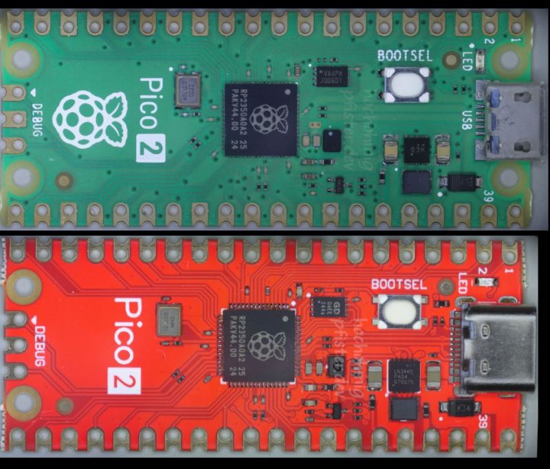

Although [Thomas] really likes the Raspberry Pi Pico 2 and the RP2350 MCU, he absolutely, totally, really doesn’t like the micro-USB connector on it. Hence he jumped on the opportunity to source a Pico 2 clone board with the same MCU but with a USB-C connector from AliExpress. After receiving the new board, he set about comparing the two to see whether the clone board was worth it after all. In the accompanying video you can get even more details on why you should avoid this particular clone board.
In the video the respective components of both boards are analyzed and compared to see how they stack up. The worst issues with the clone Pico 2 board are an improper USB trace impedance at 130 Ω with also a cut ground plane below it that won’t do signal integrity any favors.
There is also an issue with the buck converter routing for the RP2350 with an unconnected pin (VREG_FB) despite the recommended layout in the RP2350 datasheet. Power supply issues continue with the used LN3440 DC-DC converter which can source 800 mA instead of the 1A of the Pico 2 version and performed rather poorly during load tests, with one board dying at 800 mA load.

    1. The power supply section on the original Picos is remarkably robust. We ran them down to ~1.8 V, and pulled easily 500 mA from them, probably more, with the SAO badge that we did.
      Haven’t tested the Pico2, so can’t comment. But if I were designing a stepup/down switching supply for a small microcontroller dev board, I’d do whatever RPi did on that one.
    2. The USB will work fine. Full speed doesn’t care about an impedance mismatch that’s that short. The split in the ground plane is not good for RFI though.
      I would be much more worried about the 1.1V power supply issue. That’s what powers the CPU. If it becomes unstable, there will probably be glitches or lockups.

    1. and after watching – it does have stitching, cant see it without zooming in due to soldermask. Its $3.5 vs $5. Impedance would matter for USB 2.0 but rp only does 1.1, power only maters if your whole project uses piso as source, imo differences are meh, good enough for $1.5 discount.

    So the Raspberry version has a 1A DCDC. And the clone only has 800mA. Wow. When are you going to draw more than 750 mA from the DCDC on the PICO? If you need 15 times more than what the pico will ever need, why are you trusting its DCDC converter?
    So the USB wires do not match the correct impedance. With 130 instead of 90… It will work. Otherwise they would have noticed this in the first “try to program our new device”. This doesn’t earn a “pretty” prize, but it’s fine in practice.
