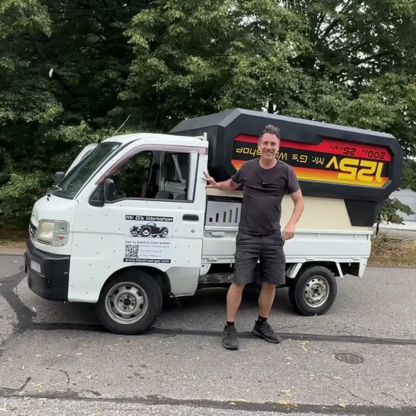

Kei trucks are very versatile vehicles, but their stock powerplant can leave a bit to be desired. If you need more power, why not try an electric conversion?
[Ron “Mr. G” Grosinger] is a high school auto shop and welding teacher who worked with his students to replace the 40 hp gas motor in this Daihatsu Hijet with the 127 hp of a Hyper 9 electric motor. The motor sits in the original engine bay under the cab and is mated to the stock transmission with a custom adapter plate made from plate steel for less than $150. We really appreciate how they left all the electronics exposed to see what makes the conversion tick.
The faux battery was made by a foam sculptor friend out of urethane foam shaped with a carving knife and then painted. It slides on a set of unistrut trolleys and reveals the 5 salvaged Tesla battery modules that power the vehicle. The fold down sides of the truck bed allow easy access to anything not already exposed if any tweaking is necessary.

      2. The battery packs aren’t that big. At least one of them could’ve been split in two and put on the sides between the front and back wheels. The other could’ve been put up against the bulkhead like a toolbox.
        It looks like some of the electronics is still on a breadboard.
      3. Well you are a bit of one, plus given the tiny size of a Kei truck turning one into a longer range personal mobility platform rather than ultralight working vehicle isn’t really that crazy – a little further refinement to this execution (like adding a door and perhaps shelves inside of the faux battery so it becomes a storage compartment) and you could easily have a vehicle with more cargo space than most small city EV, and it likely has longer range too.
        But still this is apparently a student project, which means ultimately as long as they learned something it is a victory, and probably a more useful one than many of the motor racing programs in higher education around the world – they all still seem to focus on ICE powertrain which is fine, even in many ways the right choice for racing, however the complexities of Electronics are starting to become the more sought after skill set and are skills likely to be more useful throughout the students life.
    2. This is a student project and a show piece. It’s not meant to be a transport truck. It’s purpose is to make visible all the elements involved in the conversion, not to hide them away. The big fake battery is just a whimsical attention-getter.
    3. It’s a cheap practical electric runabout, these things are a great base for something like an EV swap as they often have RWD and a ladder frame but are also incredibly small & lightweight – and if they’re a popular vehicle where the builder lives it makes sense to use a base vehicle with good parts support.
