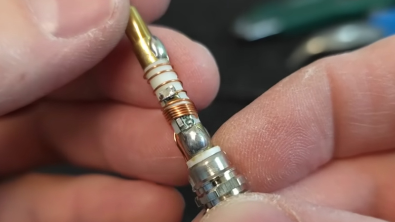

If you own a handheld transceiver of any type then the chances are it will come with a “rubber duck” style antenna. These flexible rubber-coated antennas are a compromise in performance, being significantly smaller than a wavelength at their frequency of operation. [OM40ET] has an interesting video in which he investigates this by tearing down a cheap rubber duck antenna and an even cheaper fake.

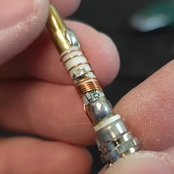

These antennas usually have a flexible upper section and a bulge at the bottom over the connector. The fake one has nothing in the bulge except the antenna wire and thus has a very high SWR, while the “real” one has a loading coil. This coil is an interesting design, because it’s designed such that the antenna has two resonant points at the 2 metre and 70 centimetre amateur bands. On paper it’s a tapped coil fed at the tap through a capacitor for matching, but a more detailed appraisal will tell you that the two halves of the coil are designed to return those two resonances. It’s still a not-very-good antenna, but the fact that it works at all is something.

I bought some of these ‘fake’ Nagoya antennas from a ‘name’ with a good reputation, they do seem to perfor but don’t look particularly good on my NanoVNA.
I think perhaps I need to slice one apart now and see what’s inside…
Colour me impressed, the dirt cheap £1.50 Nagoya clones I bought from TIDRadio have the coil, the cap and are actually tuned, I think perhaps I need to revisit my NanoVNA skills.
HT antennas are really hard to properly measure with a VNA. You need an antenna connector attached to something that will act as a ground plane. The gutted chassis of a broken HT will work for that. You also need a coax with a common mode choke near the antenna connector to connect it to the VNA. It won’t be perfect, but it will work better than connecting the antenna directly to the VNA.
