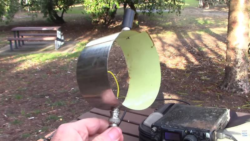

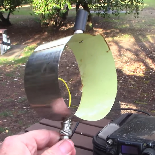

The magnetic loop antenna is a familiar sight in radio amateur circles as a means to pack a high performance HF antenna into a small space. It takes the form of a large single-turn coil made into a tuned circuit with a variable capacitor, and it provides the benefits of good directionality and narrow bandwidth at the cost of some scary RF voltages and the need for constant retuning. As [VK3YE] shows us though, magnetic loops are not limited to HF — he’s made a compact VHF magnetic loop using a tin can.
It’s a pretty simple design; a section from the can it cut out and made into a C shape, with a small variable capacitor at the gap. The feed comes in at the bottom, with the feed point about 20 % of the way round the loop for matching. The bandwidth is about 100 MHz starting from the bottom of the FM broadcast band, and he shows us it receiving broadcast, Airband, and 2 meter signals. It can be used for transmitting too and we see it on 2 meter WSPR, but we would have to wonder whether the voltages induced by higher power levels might be a little much for that small capacitor.
He’s at pains to point out that there are many better VHF antennas as this one has no gain to speak of, but we can see a place for it. It’s tiny, if you’re prepared to fiddle with the tuning its high Q gets rid of interference, and its strong side null means it can also reduce unwanted signals on the same frequency. We rather like it, and we hope you will too after watching the video below.

  1. The bandwidth is about 100 MHz starting from the bottom of the FM broadcast band
    Surely you mean “The tuning range is about 100 MHz…”
    Being such high Q the actual bandwidth will be much, much narrower.
    (maybe the video makes that clear — I can’t see it at the moment)
      1. Probably. Cut the can oversized, put a piece of plastic on one end and curl it in on itself to form the capacitor might just work. I would recommend plastic clamps though.
    1. Well, it’s mostly steel, not tin.
      And it’s not a can any more, since it’s can’t hold anything.
      Being steel, it IS magnetic.
      And, being interrupted by a gap, it’s not actually a loop.
      But, being a small fraction of a wavelength in circumference, it IS what is colloquially termed a mag loop antenna, as its near field is predominantly magnetic.
      (Or, being made mostly of steel, it’s actually just a poor dummy load.)
