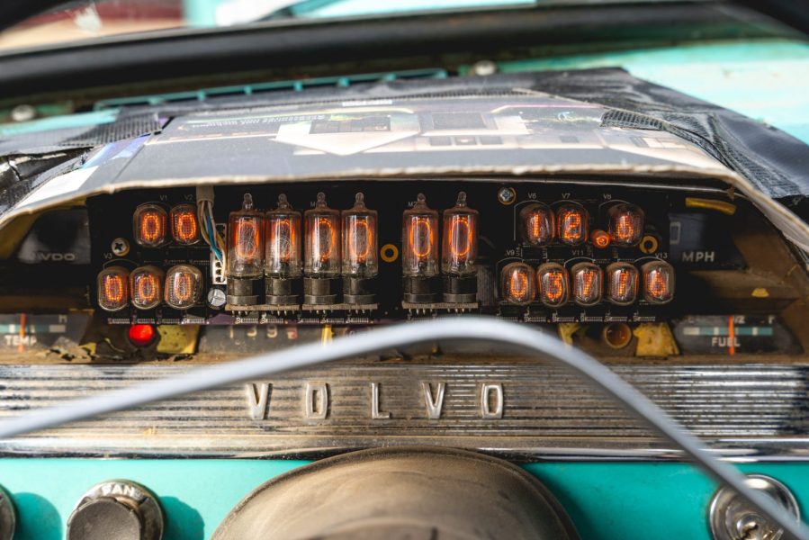

There’s no accounting for taste, but it’s hard to argue with The Autopian when they declare that this Nixie tube dash by [David Forbes] is “the coolest speedometer of all time” — well, except to quibble that it’s also the coolest tachometer, temperature gauge, oil pressure indicator, and voltmeter. Yeah, the whole instrument cluster is on [David]’s Volvo PV544 is nixified, and we’re here for it.
He’s using a mixture of tubes here– the big ones in the middle are the speedo and tachometer, while the ovals on either side handle the rest. There’s a microcontroller on the front of the firewall that acts a bit like a modern engine control unit (ECU) — at least for the gauges; it sounds like the Volvo’s engine is stock, and that means carbureted for a car of that vintage.

me likey but it would draw too many amps to be fuel efficient.
Tubes are low-current components. Typical nixie draws about two or three milliamps. By my count of the tubes in there it’s around 50 milliamps. Quite a bit more on the 12v side of the circuit, but you’d still end up drawing a lot more just from turning on the fan for the heater. Like hundreds of times more.
The smaller nixie tubes use about half a watt each. All of the incandescent light bulbs in the dash of an older car will use a lot more power.
