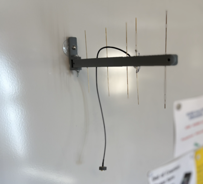

The yagi, suction-cup mounted to a wall
If you’re a regular reader of Hackaday, you may have noticed a certain fondness for Meshtastic devices, and the LoRa protocol more generally. LoRa is a great, low-power radio communications standards, but sometimes the antennas you get with the modules can leave you wanting more. That’s why [Chris Prioli] at the Gloucester County Amateur Radio Club in the great state of New Jersey have got a Yagi antenna for North America’s 915 MHz LoRa band.
Right out the gate, their article links to one of ours, where [tastes_the_code] builds a Yagi antenna for the European 868 MHz LoRa. Like [tastes_the_code], the radio club found [Chris]’s antenna gives much better reception than what came with the LoRa module. Looking out their window, instead of two Metastatic nodes with a stock antenna, one club member is now connecting to two hundred.
A simulation of the radiation pattern. Looks like a Yagi, alright.
Now, the Yagi is directional, so you only get that boost pointed down the axis of the antenna, but at least in simulation they estimate a 7.7 dB front-to-back gain vs under 3 dB for an omnidirectional antenna. Not bad, for a simple 3D print and some stiff wire!

  1. I wonder if that simulated plot includes the big steel bolt and infinite plane of dielectric right in front of the director. Maybe that’s why they got such a horrible match in the built version?
      1. I assume it was constructed “backwards” on purpose, to be placed on the other side of the nearest wall between the antenna and the signals, but yeah the metal fasteners seem like they would cause problems.
      2. Aiming it directly into a wall with a couple of steel bolts and a mounting bracket in front definitely doesn’t look right.
  2. It can be fastened on the inside or outside of the window depending on your needs, always pointing out, of course. A picture of it mounted on a window didn’t work so we mounted it on the white board.

  7. Wow – I didn’t anticipate this much confusion about the picture, but a critical point was omitted from the Hackaday description. To clarify – you do NOT mount this antenna on a metal white board pointing towards the board inside of a room. Instead you mount it on a WINDOW, either inside or outside (the boom is drilled to allow mounting at either end) pointing OUTWARDS. The picture is that way because attempting to photograph something mounted on a window results in the camera focusing on objects outside of the window, and it’s hard to get the intended subject in focus. The paragraph above the picture on our website begins: “To mount the antenna securely on a window while pointing outward…” so I thought that the intended use was obvious and therefore didn’t take more time in trying to get an accurate picture. Apologies to anyone who believed that the antenna was intended to be used as depicted.
    Re the gain figures, note that our website does not refer simply to an “omnidirectional antenna” but rather to “typical stock omnidirectional antennas”, which for these radios are often shortened half-wave dipoles that have gain in the 2-3 db range. I didn’t write the Hackaday text that shortened that sentence.
    We did the ERP calculations based on the output power of the typical 915 radio using this antenna and found it to be well within the legal ERP ranges.
    Our goal here was to (a) show and provide building details of an antenna that our members have found to significantly improve the effectiveness of their 915 radios and (b) to create a potentially interesting group project, which involved about two dozen of our members in a work session for a couple of hours. If your goals coincide with either of these, you’ll hopefully find this project useful.
