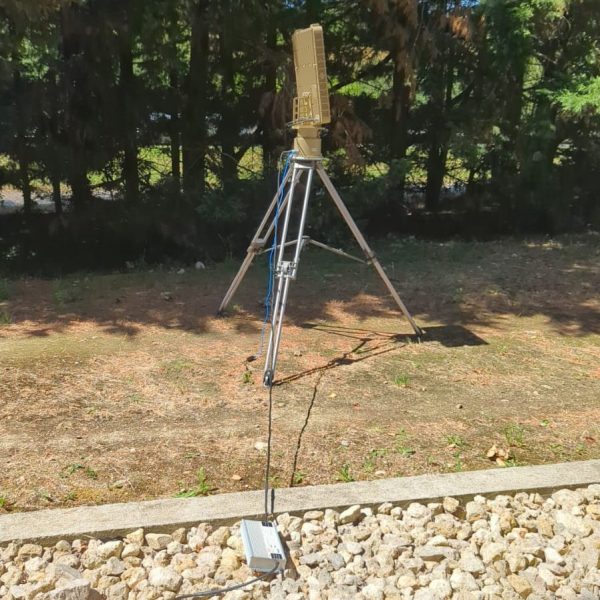

The design is called the AERIS-10, and is available in two versions. Operating at 10.5 GHz, it can be built to operate at ranges between 3 or 20 kilometers depending on the desired spec. The former uses an 8 x 16 patch antenna array, while the latter extends this to a 32 x 16 array. Either way, each design is capable of fully-electronic beam steering in azimuth and can be hacked to enable elevation too—one of the most attractive features of phased array radars. The hardware is based around an STM32 microcontroller, an FPGA, and a bunch of specialist clock generators, frequency synthesizers, phase shifters, and ADCs to do all the heavy lifting involved in radar.

  10. Thank you to the Hackaday team for featuring my project, and to everyone who took the time to comment—especially those with genuine questions and concerns. I want to address the most common themes directly.
    On Legality & Regulations
    This is the #1 concern, and rightly so. I am an electronics engineer in Morocco, and I am working closely with regulatory consultants to ensure compliance. The system is being designed with:
    Experimental licensing for development and testing
    Path to certification (FCC/CE) for commercial versions
    Power levels carefully chosen to stay within legal frameworks where possible (the 20km version uses 16x10W GaN amplifiers, but effective radiated power is managed via duty cycle and antenna gain)
    For those asking about amateur radio: this is not intended as an amateur radio device. It is a radiolocation system, which falls under different regulations (Part 90 in the US, equivalent in other jurisdictions). I am not claiming it’s legal to operate without a license—I am building it to be certifiable.
    On “LLM Slop” & Language
    Yes, I used AI to help draft some descriptions. English is not my first language, and I wanted to communicate clearly. The hardware, firmware, and design work are mine—every schematic, every line of VHDL, every PCB trace. If you want proof, the GitHub repository contains the full design files: https://github.com/NawfalMotii79/PLFM_RADAR
    On Mechanical Scanning vs. Full Electronic Steering
    The current prototype uses a stepper motor for azimuth and electronic steering for elevation. This was a cost/complexity tradeoff to get a working system built. However:
    The architecture supports full 2D electronic steering with additional phase shifters and amplifiers
    The “hackable” comment means: if you want to build a version with 360° electronic scanning, the digital backbone (FPGA, clock distribution, beamforming logic) is ready—you’d just need to add more RF front-ends and antenna elements
    On Documentation & Design Files
    Some commenters noted the project seems incomplete. The GitHub repository contains:
    Full schematics (in /4_Schematics and Boards Layout)
    Bill of Materials
    Firmware source code
    PCB layout files
    Simulation results
    It’s an evolving project, not a finished product. That’s the point of open source—to build together.
