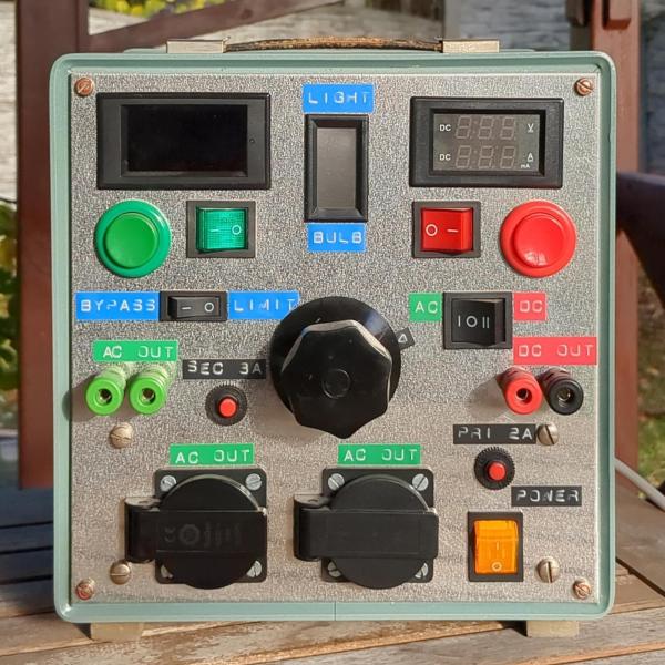

When you’re testing or debugging some mains-powered gear, plugging it directly into the outlet can often be an exciting proposition. If such excitement is not really your thing, you can opt for an isolation transformer and other types of safeties. In the case of [Michał Słomkowski], he opted to take a few steps further by modding a vintage East-German isolating variac with a broken amp meter into an isolated AC/DC power supply and testing station.
The core is formed by the isolated variable transformer, to which a configurable DC output section, a current limiter and digital voltage and current read-outs were added. This enables a variable AC output of 0 – 330 VAC and 0 – 450 VDC on their respective terminals, with the incandescent light bulb providing an optional current limiter.
In its final configuration [Michał] has been using the device for the past four years now for a range of tasks, including the simulating of various undesirable mains power conditions, varying the speed of an old Soviet-era drill, powering vacuum tube devices, capacitor reforming and of course running 100-120 VAC devices from e.g. the US.
As far as feature set goes, we have to admit that it is an impressive device, indeed. Although some parts of it are clearly playing it fast and loose with best practices, with [Michał] admitting to not being an electrician, it was clearly engineered well enough to survive a few years of use, something which cannot be said for even professional laboratory equipment these days.

  1. I’m no EE, and not even a good hobby-ist, but that schematic is a mess. While I get the intend of some parts, things just don’t click logically for me. Every corner I’m hmm, I think this is what it means, by then why …
    Also the front panel is messy.
    Having said that, I think it’s a great project and I couldn’t quite pull this off and I do like the retro? Style of the panel :)
      1. Yeah, looking at it a second time, it’s really Nice, what threw me off is the fuses, those are the only two not in sync, the somehow stood out ..
        o I stand corrected, really nice panel, except the misalginment on the fuses :p

  3. I have two comments regarding safety.
    1: the fuse F1 is ins the Neutral line – totally wrong!
    2: F1 and F2 are Auto fuses which, I believe, are rated for 32V – NOT 240V!!
    1. 1: You are totally wrong. There is no fixed neutral.
      CEE 7/7 plugs can be plugged in either way in ~half the available receptacles.
      -> You can never be sure which side is neutral or phase (or if both are floating).
      2: Pretty sure they are available for higher voltages as well (I think I have some).
      I think many small in-line UPSs have those – and not in the battery circuit.

  6. I don’t understand the connection between K2 and K1. I don’t see purpose apart from maybe sharing LA1 (?) for DC and AC and it may even be harmful when K1 and/or K2 don’t turn off quickly enough.
    As Oliver pointed out the schematic looks messy, which may not help with reading this part accurately.
    1. Hello, author here.
      The schematic indeed looks messy, that was is mainly because of 3PDT relay symbols available in KiCad. I didn’t feel the need to go extra mile to make my own symbol for it.
      You’re right that the connection is make because of sharing LA1. I use all three contacts to break the path of the current in many places.
      I did a quick check of the schematic for the hypothetical situation when both relays stay closed for some reason and both loads for AC and DC are connected. It seems, the variac would be shorted out by one of the diodes in the bridge rectifier and blow one of the fuses.
    2. That interconnect is the only part of that fine(!) schematic I couldn’t decipher on 1st try.
      But you bring up a good point – let me draw it further:
      If both AC & DC were on at the same time (relays K1 & K2 active) it would be a whole lotta mess.
      Now let me counter it: This ^^ can never happen because the main selector switch on the other side (SW2A+B) makes sure only one of K1/2 can be on at any given moment – never both.
