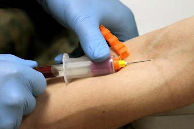

These days, if you get blood collected for testing, there’s a plenty good chance you’ll have it drawn into a vacutainer. It’s named as a portmanteau of “vacuum” and “container” because that’s fundamentally what the system relies upon. A vacutainer is a glass or plastic tube which holds a vacuum inside, sealed with a stopper. That vacuum can be used to help extract fluids to be stored inside the container—namely, blood, in most cases.
The method of use is relatively straightforward. A vacutainer needle is inserted into a patient’s vein to access the blood. The vacutainer needle does not have a typical syringe draw. Instead, the back end of the needle sits inside a plastic housing which accepts vacutainer tubes. There is a flexible rubber seal on the back end of the needle so blood doesn’t leak out when no tube is connected.
When a vacutainer tube is inserted into the housing, the vacutainer needle pierces the stopper of the tube. The vacuum inside then draws blood from the vein into the tube for collection. When full, the tube can be removed and it self-seals as the needle comes out of the stopper. Another tube can be quickly clipped into the vacutainer needle housing to draw further blood if more is needed, without leaks or mess causing contamination issues.

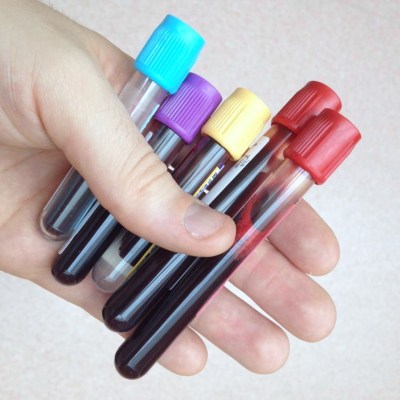

Vacutainer tubes are, by design, single use. They’re manufactured to capture a set quantity of blood for testing, based on the level of vacuum in the tube at the time it is sealed, and are disposed of after use. Labels are often included on the tubes allowing patient information to stay with the blood itself. Tubes have a shelf life, as with most medical paraphernalia, in particular since they may not maintain vacuum indefinitely.

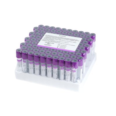

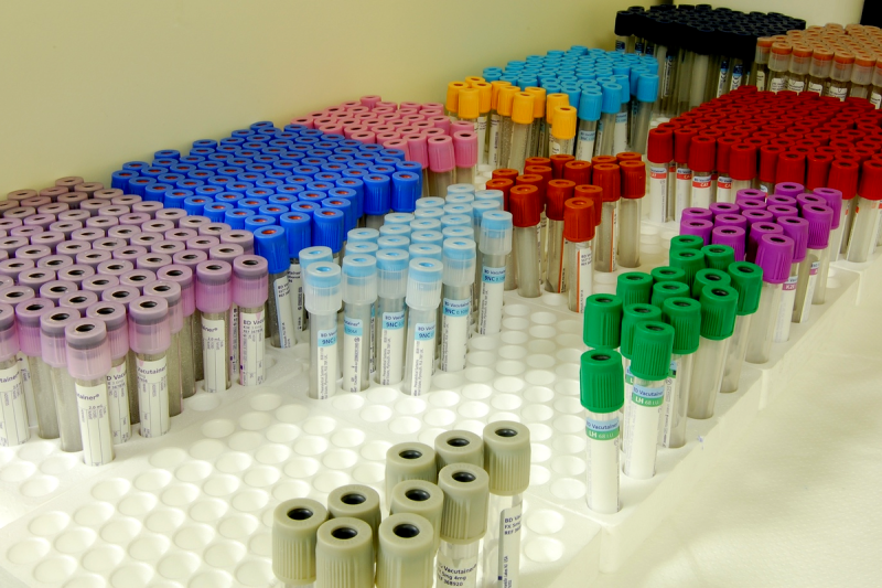

The tubes are also typically filled with various additives in order to best preserve and prepare the blood while it awaits testing, and stoppers are color-coded to indicate this. The precise additives used are highly dependent on the testing required. A tube for a standard blood culture draw will typically be filled with sodium polyanethol sulfonate, which acts as an anti-coagulant, with growth media also present for microorganisms.
Coagulation tests will use tubes with sodium citrate inside, while a test for lead will often use a tube with sodium EDTA chelator inside. Some basic blood component tests will use a plain tube with no additives, while others are highly specific—tuberculosis testing often uses purpose-made tubes with antigen additives ready to go. Some tubes include special serum-separating agents which help with splitting blood into its component parts when shaken or centrifuged, useful for certain tests that look at different blood cell types individually.
If you’ve ever dared to watch while having your blood drawn in this manner, the technology can look quite swish. The tubes are easy to hotswap without leaking any blood and several tubes can be filled in under a minute once the phlebotomist has found an appropriate vein.

They are very neat, the order of use also matters.
The classic ones are the light blue used for clotting tests uses a specific amount of additives. If you try to fill them first then they under fill since they need to take up the air in the line.
But you can also risk contamination, so you can also find plain tubes partly to go first and empty the line before you start your draw.
The other classic is blood cultures often you’d want aerobic and anaerobic draws.
You obviously would not want to draw the anaerobic one first and find it full of air and oxygen! You also need to of course be sterile with the draw to avoid contamination.
For whatever reason the culture bottles are big glass bottles.
Sometimes its just colour coding for specific tasks and they might be otherwise identical. Purple is EDTA and Lilac/pink K2 EDTA. The purple is probably also K2 EDTA (or well could be).
But the pink is for the specific task of cross matching blood for transfusion and you don’t want that to happen by accident hence splitting it away from the often used purple. It will be bigger usually and have stricter labeling requirements.
