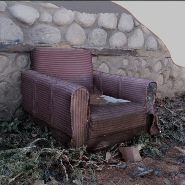

  1. Based on the intro pics, I am not sold on the output quality: stone wall looks like Legos and vegetation has severe artifacts and appears unnatural. But, I can understand why a open-source beginning that even is limited is a great start.
    1. He mentions in the video that particular example was processed at only medium quality, so that’s not the limit of what the tools are capable of. At any rate, all the various tools which make the output are not what’s being shown here, rather the wrapper combining them all into a single workflow.

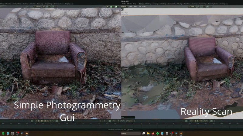

  2. I know I could google it but HAD comments always dial it right in for me and keep the rabbit holes at a distance. Could someone explain what exactly this is for? I just see chair one angle chair and chair different angle with some blurs. Is it to remove the blurs??? Was it because they wanted more crap on the ground?
    1. It’s to create a 3D model from multiple photos from different angles.
      The left image looks like a point cloud, the right is the “solid” model seen from an angle.
      1. The left image is done using this tool, the right image is done using a paid service called RealityCloud. So this is just showing the side-by-side comparison of this FOSS option compared to a paid service.
