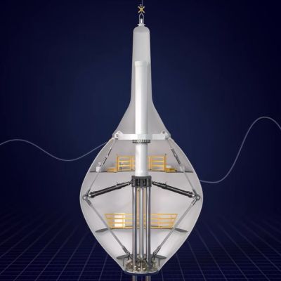

Internal view of the CorPower Ocean wave turbine buoy. (Credit: CorPower Ocean)

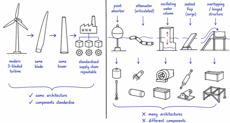

One of the main problems is simply one of cost, with wind energy having converged on a single design involving effectively the same three-bladed rotor, gondola and tower design that has been optimized for decades now. For wave energy there’s no such one-design-fits-all solution, with each attempted design having its own advantages and disadvantages that may prevent it from working in various sites, or incur high maintenance costs in the highly abusive marine environment.
Having more energy in waves than in wind is also both a benefit and a curse, as wave turbines have to work with the waves and not get demolished every time there’s a storm. Even wind turbines regularly fail in windy weather when e.g. the brakes fail, under conditions that would be considered mild in a marine context.
Also covered in the video is a new contender, in the form of CorPower Ocean’s new buoy-like design that bobs up and down on the surface. Here you need to carefully tune the turbine mechanism to work with the wave motion to extract the most energy. Their current design is be 19 meters tall, 9 meters wide and claimed to be capable of being installed in >40 meter deep water, producing power with a 40-60% capacity factor at 300 kW.
As yet another attempt at making wave energy turbines work, the most exciting aspect of it will be to see whether it can survive adverse weather, when careful tuning gets tossed out of the window and chaotic waves pummel what is essentially a very big hollow buoy. The single prototype has so far survived bad weather off the coast of Portugal during a year of testing, but the real test is long-term survival, as losing half your wave turbine farm to a really bad storm every five-odd years would quickly scuttle the project like it has previous commercial contenders.

    2. The minimum spacing of the 0.3MW Corpower buoy is 150m so the output is 13W/sqm. The minimum spacing of a 25MW wind turbine is in excess of 2000m, so the output is 6W/sqm, so the addition of Corpower buoys to a windfarm would increase the yield by 200%, not 5% as you claim.

        1. If you put one CorPower buoy directly behind another and only a few metres behind then it is true that the one in front would shade the one behind, just like wind turbines do. But if you seperate the buoys by 150m the effect is negligable because of difraction and mixing, just as it is when you seperate wind turbines by large distances.
          The waves arriving at a buoy may have originated by wind exciting the water surface hundreds of km away so power is accumulated over a very large fetch. As I demonstrated previously, the power density available to a wave energy farm is higher than the power density available to a wind farm.
          I got the 150m minimum buoy seperation from the CorPower website. When you consider the buoy is 9m in diameter It seems reasonable, just as a 2km seperation seems reasonable for a 300m wind turbine. If you wish to dispute my calculations please provide an alternative minimum seperation with a source.

          The huge reduction in windpower costs has been acheived by experience as well as size. Increasing size is not an option for single point wave power generators, but industrialization, mass production and institutional learning is.

        Wave generators don’t scale up in power as well, because the energy is coming in the form of surface waves. The energy harvesting interface is a 1-D line along the water, while a wind turbine traces a 2D surface in the air. Doubling each generator’s linear size doubles the power of the wave generator, and quadruples the wind turbine because the swept area grows in the square of its dimensions.
        That’s why it’s much harder to scale up a wave generator from 300 kW towards 25 MW. Most likely you’ll never get there, because the unit size would become so ridiculously huge that you can’t manufacture it anywhere.

          Scaling up CorPower buoys wouldn’t get you anywhere because they are tuned to the prevailing wave height and period. For sure there are economies of scale in large wind turbines, but there significant disadvantages too. The small number of such turbines inhibits industrialization, and the installation requires special expensive equipment. This is why Heinrik Stiesdal, a pioneer of wind power and holder of 650 related patents, now advocates smallish 3.6MW turbines which can be mass produced and easily installed. This small output repeated many times is the approach CorPower is taking, and mass production and simple installation was designed in from the very beginning.
