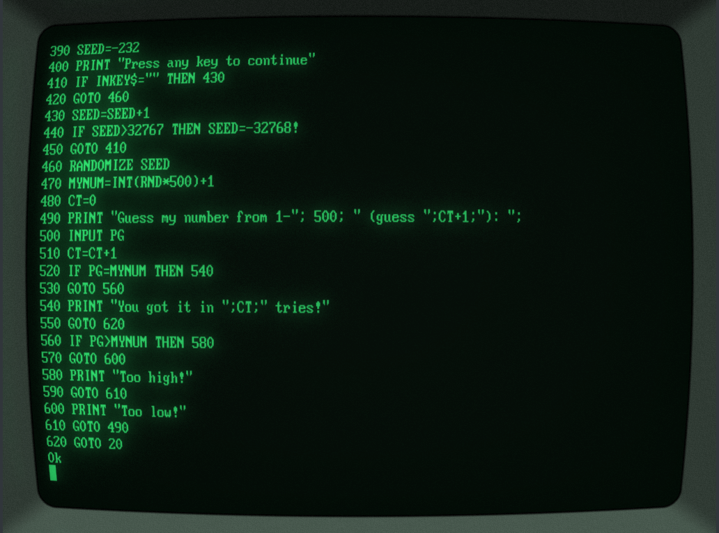

The BASIC code, including a few lines of the library, is much harder to read:
10 DIM LBLBSTACK#(8):LBLBSP=0
20 I=3141
30 gosub 230
40 print "I is now:";I
50 PRINT "Starting number: ";
60 INPUT CT
70 PRINT "1-Up, 0-Down: ";
80 INPUT UD
90 OFFSET=-1
100 IF UD<>0 THEN OFFSET=1
110 ':CDLOOP
120 IF CT>=0 and CT<=9999 THEN 140
130 GOTO 180
140 NUM=CT
150 GOSUB 330
160 CT=CT+OFFSET
170 GOTO 120
180 CT=0
190 IF OFFSET=-1 THEN CT=9999
200 GOTO 120
210 END
220 ':init
230 IF LBLBSP+1>64 THEN PRINT "BAL stack overflow":STOP
240 LBLBSTACK#(LBLBSP+1)=I:LBLBSP=LBLBSP+1
250 DIM D(9)
260 FOR I=0 to 9: READ D(I): NEXT I
270 DATA 63,6,91,79,102,109,125,7,127,111
280 X=12:OUT 3,X
290 IF LBLBSP<1 THEN PRINT "BAL stack underflow":STOP
300 I=LBLBSTACK#(LBLBSP):LBLBSP=LBLBSP-1
310 return
320 ':sendnum4
330 GOSUB 500
340 B=64:GOSUB 610

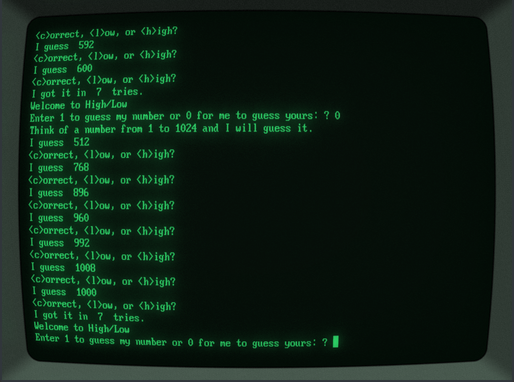

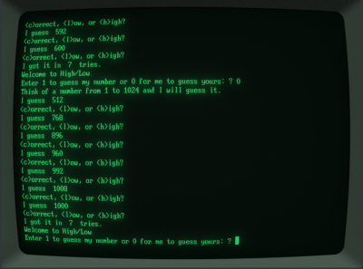

One of the HILO games running.
If you haven’t used the TM1637 before, it uses a serial protocol with a clock and data line and is very forgiving of timing. The display update speed is quite slow, partly because MBASIC isn’t that speedy and partly because the Z80 chip communicates to the outside world via another microcontroller talking over an I2C bus. But non-BAL code would be just as slow on the same computer. You’ll notice, though, that I took all the delays out and the code and it still works fine.
The bigger sample, though, is HILO.BAL. This lets you set a few compile-time constants that let you select what parts of the program get built. It also makes good use of the control loops. Of course, if you really want to dig in, lblbasic.bal uses quite a bit of the awk-compatible syntax and is a substantial program: around 1300 source lines of BAL which generate nearly 900 lines of regular BASIC due to comment and white-space stripping.
