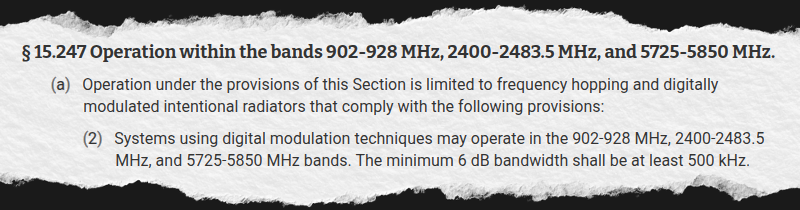

But if we go back to October of last year, we can see the first signs of potential trouble. Issue #945 in the MeshCore GitHub repository points out that the default radio settings in the US for both it and Meshtastic would appear to run afoul of FCC regulation 15.247. Specifically the second paragraph of subsection (a), which dictates the minimum allowed bandwidth. Out of the box MeshCore operates at 62.5 kHz and Meshtastic uses 250 kHz, but the FCC says it needs to be 500 kHz or higher.
The resulting discussion, which spans several hundred messages and is still seeing activity as recently as this week, paints a fascinating picture and illustrates one of the reasons it’s taken so long for the issue to gain traction. Although the text of 15.247 may seem straightforward enough at first glance, there’s always room for interpretation with documents like this.
Some pointed out that subsection (a) states that it is “limited to frequency hopping and digitally modulated intentional radiators,” as evidence that it doesn’t apply as neither project utilizes frequency hopping. Others felt that the rules were only intended for devices with higher output power, and some even expressed a disbelief that the manufacturers would allow the modules to operate in a non-compliant mode in the first place.
Put simply they couldn’t decide if 15.247 was something they really had to worry about, and without any official word coming down from the FCC, were reluctant to throw the community into turmoil over it.

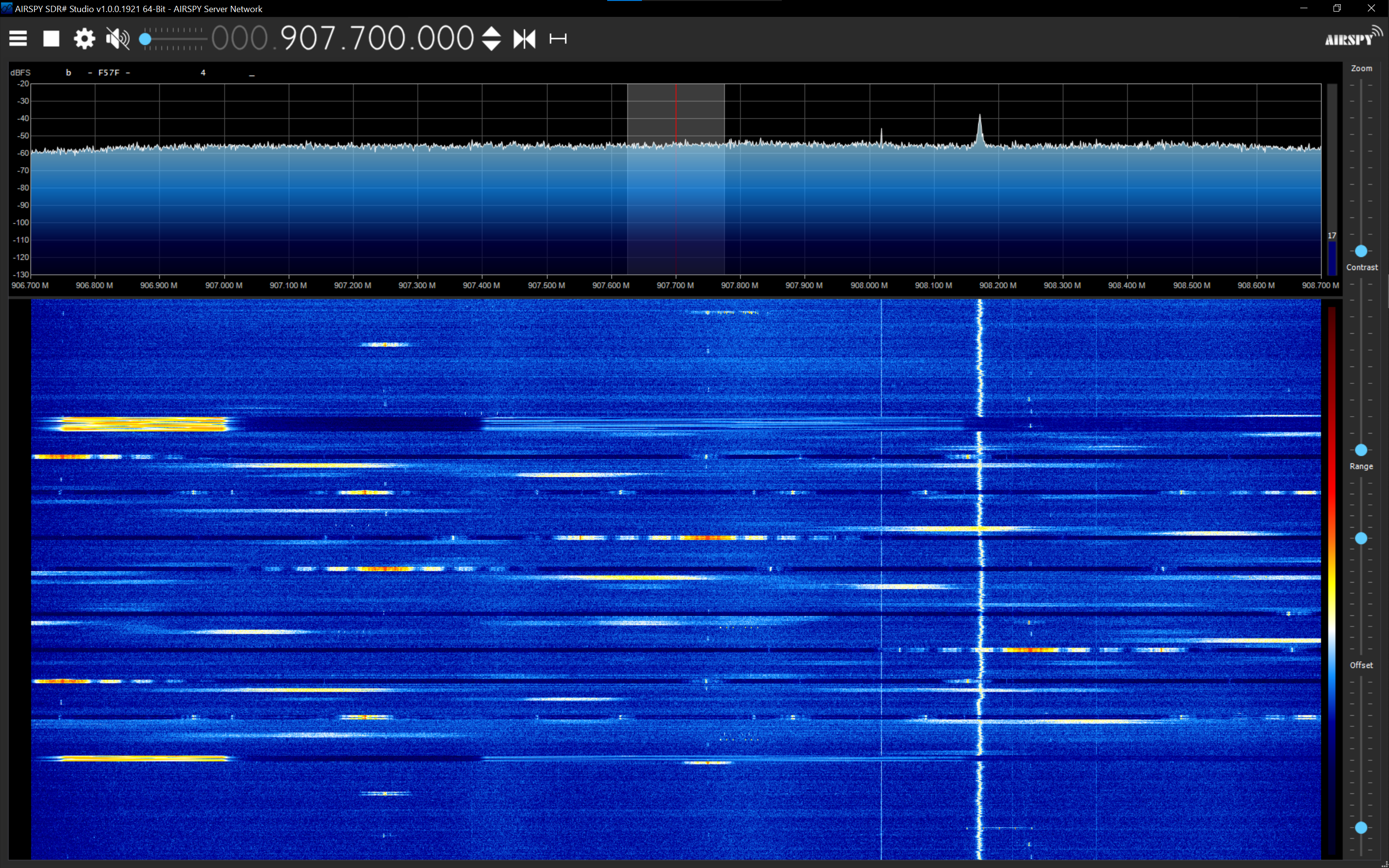

But the biggest problem they encountered was interference from other devices on the ISM band. In a dense urban environment like Philadelphia such interference is essentially unavoidable, but they found that Meshtastic operating at 500 kHz was especially susceptible to the electromagnetic din of the city. From their investigations, they theorize that the narrower bandwidth used by Meshtastic’s default mode was better able to slip through some of the interference, while the wider 500 kHz mode was more likely to collide with other transmissions.

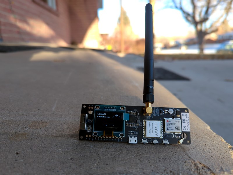

Featured image: “Meshtastic T-Beam” by [Chiffre01]

The split in §15.247 is:
§15.247(a)(1) → Frequency hopping systems (FHSS)
Hop count, dwell time, 20 dB BW limits (≤ 500 kHz), etc.
§15.247(a)(2) → Digitally modulated systems (DTS)
Minimum 6 dB BW ≥ 500 kHz.
The distinction is hopping vs non‑hopping, not spread vs non‑spread.
LoRa radio modules are certified as DTS, and the CSS modulation is granted an exception from the 500 kHz minimum because it is recognized as spread‑spectrum…. Narrow bandwidth allowed due to CSS spreading gain. Operates legally under §15.247 at DTS power levels.
Probably under industry lobbying, FCC found a home for certifying LoRa modules that would preserve the technology benefit to long range, low bit rate. This is why LoRa at 62.5 kHz or 250 kHz is legal because FCC itself granted an exception to the DTS minimum bandwidth requirement and FCC allows labs to certify as such.
More technical detail is in FCC radio module certifications that use SX127x/SX128x and Semtech’s application note “AN1200.26: LoRa and FCC Part 15.247: Measurement Guidance” is the smoking gun. It explicitly describes how LoRa is evaluated under FCC Part 15.247 as a digital transmission system (DTS/Hybrid). The emission designators are all under 500kHz BW (like 250K0D7D).
