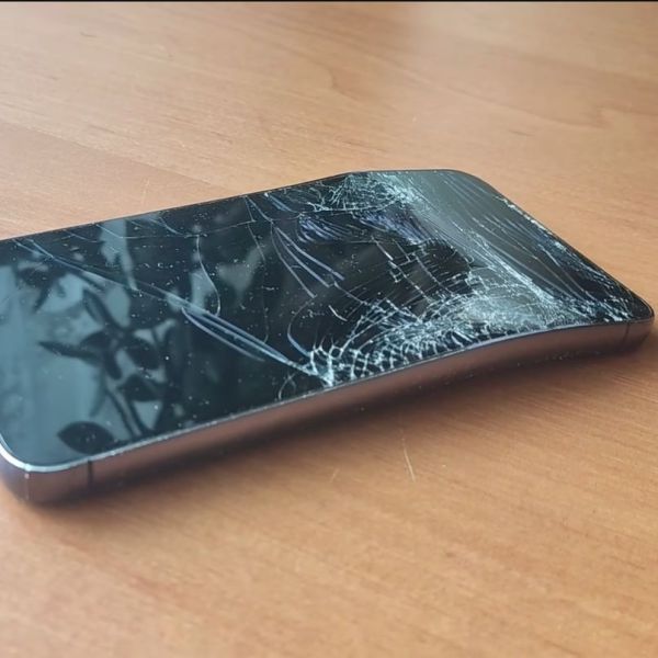

Repurposing old smartphones for more general purpose computing isn’t a new thing, but the project by [LastComputer] ups the ante by going from a Samsung Galaxy S23 that looks like it got run over by at least a few cars to a very serviceable gaming computer, courtesy of its Snapdragon 8 Gen 2 SoC.
The somehow still working but definitely worse for wear phone was purchased for 1,700 Ukrainian Hryvnia (~$40). It being SIM locked also helped reduce the price, even if someone had somehow wanted to use it again as a phone. Since the SoC inside is also used in quite capable gaming handhelds, but with good cooling, that would be a real waste.
Converting it into proper gaming system requires some careful disassembly, some gentle whacking with a hammer to straighten out the frame and a new battery as the mainboard won’t work without one installed.

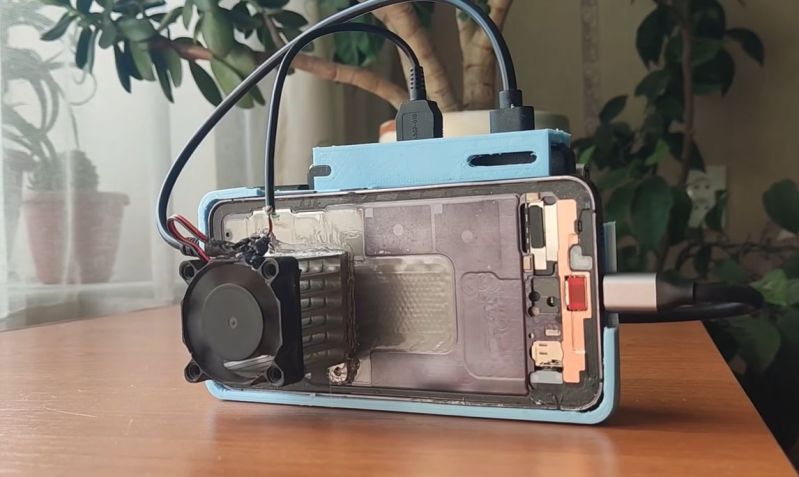

A 3D-printed phone case glued to an SSD cage for the 512 GB SSD serves as the enclosure, along with two USB hubs, one of which also provides HDMI output. For the active cooling system a heatsink was hot-glued to the vapor chamber with a properly sized fan mounted to it. Here we could definitely see some zip ties being added to prevent it from falling off.
Compared to running the phone in its stock cooling configuration this shaves off about seven degrees C, with thermal throttling noticeably reduced. This consequently provides a much better desktop experience in Samsung’s DeX (Desktop eXperience) desktop mode, which is what’s used for running applications and games.
Running God of War as an emulated PS2 game works pretty well, as does running games with the Dolphin emulator and the GameHub app using which PC games on Steam, GoG and others can be run. Although you can also install other OSes on the phone hardware, Samsung DeX doesn’t appear to be a bad option if you happen to repurpose a high-end Samsung phone that supports this mode.
