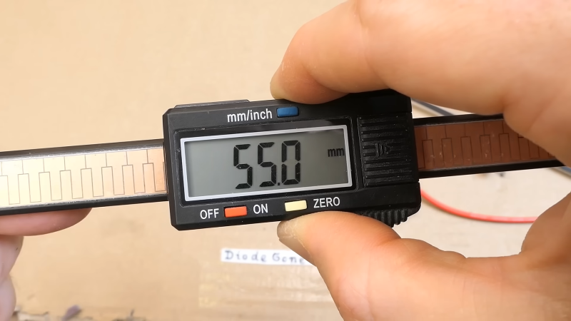

Most hackers and makers end up with a cheap pair of calipers in the toolbox at some point or another. [DiodeGoneWild] decided to take a particularly cheap plastic pair and tear them down to see what makes them tick measure.
The electronics is, unsurprisingly, all contained inside the carriage which slides along the ruler. The ruler itself has an etched copper strip inside, underneath the scale sticker, with repetitive T-shaped sections. Meanwhile, the PCB in the carriage has a series of plates for capactive sensing. As the carriage slides along the copper strip inside the ruler, the capacitive sensing plates pick up varying capacitances which are directly proportional to how far the carriage has moved, allowing for precise measurement of relative position. Zeroing is a job for the user, via the ZERO button. We get to see how this works on the bare hardware level, and [DiodeGoneWild] even breaks out the oscilloscope to help show us what’s going on.
[DiodeGoneWild] also notes that these calipers are particularly frustrating for how quickly they discharge batteries while in storage. This may be down to the convenience feature, wherein moving the caliper switches the display on. There’s no hard off switch here—so the caliper is always drawing some juice even when it’s just in the cupboard. This is why these things are forever turning up dead when you need them.
If you’ve never pulled apart one of these cheap tools, this is a great way to see what’s actually going on under the hood. We’ve seen some other great teardowns lately, like this deep dive into a cheap pair of smartglasses. Video after the break.

These exact calipers are a legend on the 3dprinting subreddit, and the story is that the battery NEVER dies. I’ve had one for years and only replaced the battery once, despite my kid using it as a sword regularly.
I’m guessing it’s more a problem with batteries that have been sitting in closets or on shelves for years before you pop them in the device.
I doubt it. i had the same callipers and it would kill a battery in a month. then it bricked itself, so i bought a vernier callipers and learned how to read it.
My experience as well. They drain the battery just sitting in the drawer. Fortunately I have a vernier caliper and an old-style dial caliper as well. They get used, the digital caliper just sits.
Try turning them off when not using them. They’ll last for years then.
I’ve got one from Lidl that looks suprisingly identical to this one and yes the batteries die within days if left in despite the display being off. Case in point being I put a new battery in mine a couple of weeks back, using it for a few minutes each day, some days I remove the battery some I leave it in. Tonight the readings were going crazy indicating dead battery already.
When I first got it I used it for a short while then put it away with battery in. Came back a few months later and it was dead as a dodo so my first assumption was the caliper had died as surely a battery wouldn’t die after a few months of doing nothing. Now I’ve learned to take the battery out as soon as I’m finished but still forgot sometimes.
Same here, mine worked always for less than a week, that’s till I glued a AAA battery holder on the rear (where the sticker Is placed) then welded the two wires where the little tiny battery was placed, clip some gap on the lid to pass the cables, and then place a rechargeable AA battery…. A now this cheap calipers has been working for more than 3 months without the need to recharge the battery…. Hopes it helps you too.
A buddy of mine strapped an alkaline D-cell to the back of his; this was like 20 years ago and I’m sure it’s still running!

Almost all of the cheap calipers eat batteries.
It’s not that they turn on when the calipers turn on when the measurement changes.
The problem is that the power button turns off the screen, and not the whole device.
They are LITERALLY always on.
They could have simply been designed with a physical battery disconnect switch as the on/off, but alas, they are not.
They all need the batteries removed between uses, or a hardware battery disconnect switch modded in.
Mine kept killing the coin cell batteries, I glued a salvaged single AAA cell holder to the top of the carriage and soldered 26ga scrap wires to the terminals. Been several years without a change now, not bad for a 10min time investment
Surely there’s space enough inside the caliper to wire in a small on/off switch that cuts the battery connection, right?

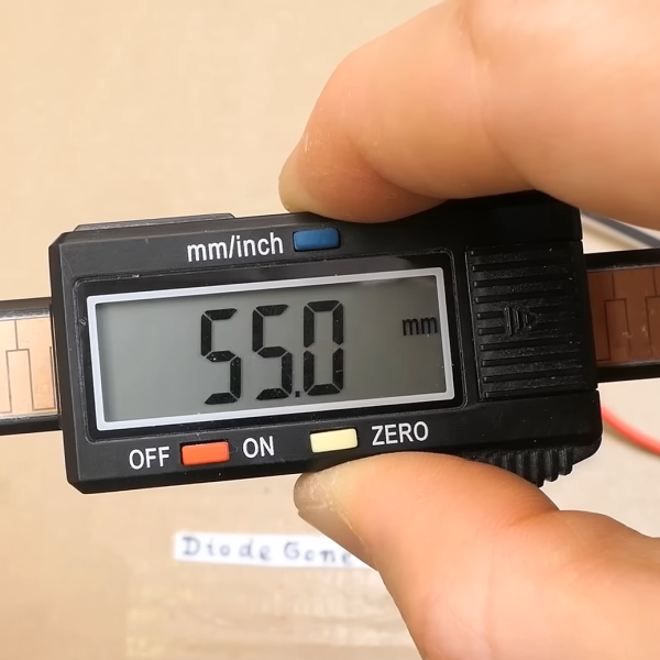

From what I can remember the cheaper callipers tend to use capacitive sensing
While the more expensive ones (such as Mitutoyo) can use inductive sensing instead.
Inductive being more resistant to contaminates such as oil on the slide.
I think the two things to make the battery last as long as possible are
1. if you use the more expensive ones (Mitutoyo) which use less power when not active
2. Use of silver oxide batteries, these tend to keep the voltage constant for longer, but then have a short drop off at the end of they’re life
