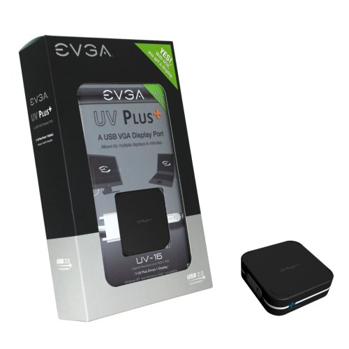

[Hunter Davis] is playing games like Contra, Monkey Island, and Quake 3 by running them on a Seagate Dockstar. We were shocked after seeing how well these run in the video after the break. [Hunter], who used the ZipIt for game emulation in the past, added a couple of hardware peripherals to get everything running. For sound he picked up an inexpensive USB sound card which was no problem to get up and running. Next he picked up a USB to DVI adapter and fired up the Linux USB DisplayLink driver. With the peripherals running he loaded up Fluxbox and the rest was history. Not bad for a small network storage adapter.

    yea – but the beagleboard costs more $$$
    the usb2vga can be found with rebates at around $30 – if u r lucky

  7. anon says:
    FYI – the rebate on the DisplayLink adapter that can be used on the dockstar expires tomorrow!!!
    1/3/2011
    I have two dockstars one from bensoutlet at $25 had the 256 meg nand and another from tigerdirect that at $30 had the 512 meg nand ; there are two different models of the dockstar a B & C version B has more nand ; but it’s really just luck which one you get

    There’s been a lot more like this worked on over at the Dockstar hacking forums. Peter Gunn’s worked on a way to get the Picture Frame LCD keychains (previously featured on Hack a Day, even) to work as a general purpose monitor, complete with curses support. No longer limited to using LCD4Linux now. He added DisplayLink support to his program so now getting video on the dockstar with his application is no longer limited to the 128×128 resolution keychains. He also had to do a few things to get audio working smoothly on the Dockstar, but the bulk of the work has already been done and figured out thanks to the folks over here: http://forum.doozan.com/list.php?2
