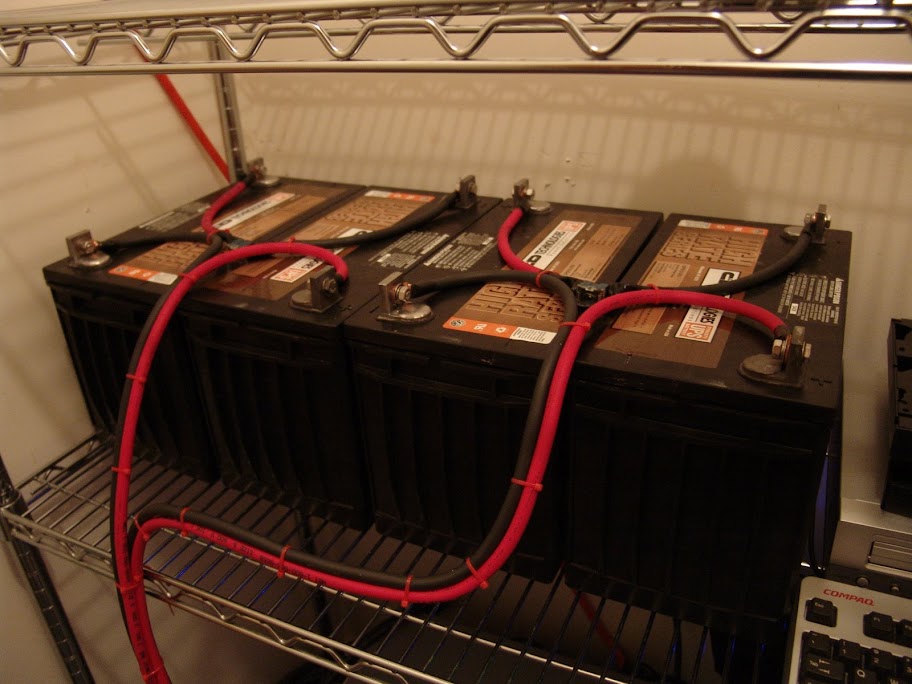

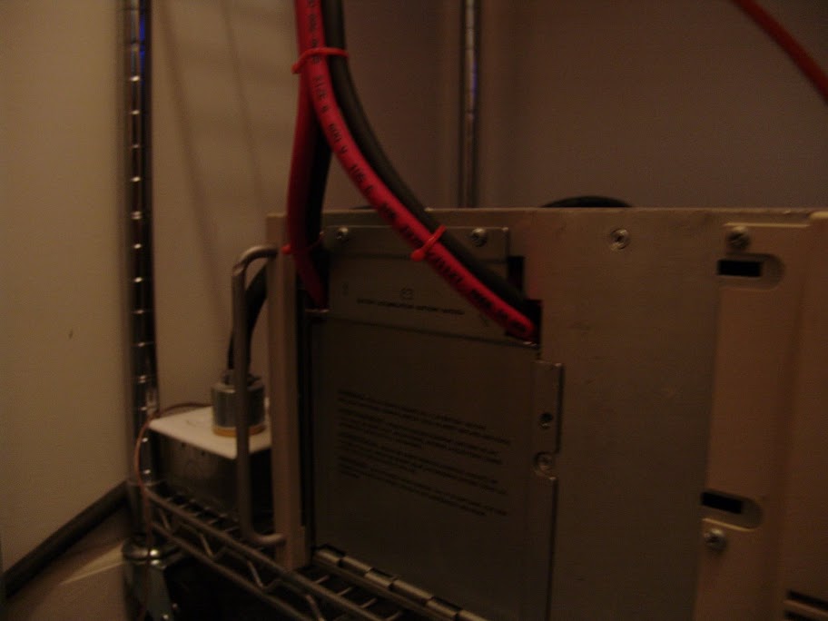

  5. LOL. If you think that’s cool, check out my UPS revamp! I’ve gotten HOURS of uptime out of it, and the ups is rated for 30 amps, and today sits in my basement, hardwired. I’ve also since made some corrugated plastic covers to keep anything from touching the tops of the batteries by accident.
    The cable I used is 6 gague, which was thicker than the cable used internally as designed by APC, and there’s 100 Amp fuses in line. Each of those copper lugs was soldered on with a vice and blowtorch. The two serial sets of batteries in the pics are themselves used in serial by the UPS for 48v@100A.
    Batteries: http://lh6.ggpht.com/_Bz7xoI4bnUY/ROPQUhVIABI/AAAAAAAAABg/nxYDtw_g0wE/s912/DSC02550.JPG
    Closeup: http://lh6.ggpht.com/_Bz7xoI4bnUY/ROPQ5QelABI/AAAAAAAAAAk/IV6YAcUiIWk/s912/DSC02551.JPG
    Cables: http://lh6.ggpht.com/_Bz7xoI4bnUY/ROPRbFhyABI/AAAAAAAAAAw/4SsJnoUoh_0/s912/DSC02552.JPG
    Connector: http://lh6.ggpht.com/_Bz7xoI4bnUY/ROPPCpJ4ABI/AAAAAAAAAAM/xOpNaq0nP7M/s720/DSC02548.JPG
    Cables tucked away nice and tidy: http://lh6.ggpht.com/_Bz7xoI4bnUY/ROPTyvfgABI/AAAAAAAAABQ/yLtwZNCXkrw/s912/DSC02556.JPG
    Whole System: http://lh6.ggpht.com/_Bz7xoI4bnUY/ROPPCpJ4ABI/AAAAAAAAAAM/xOpNaq0nP7M/s720/DSC02548.JPG

  21. IIRC, marine batteries don’t give off any gas. They are sealed. Car batteries on the other hand should not be used indoors without proper ventilation.

  28. I have a 6kw double-conversion inverter that runs most of my house (double-conversion = everything runs on the inverter all the time). I did this upgrade back in October. Added 16 deep-cycle batteries, giving me 22kw in the battery bank vs. the original sealed batts that only had a few thousand watts. One recent test ran most of my house normally for 17 hours.
    Don’t worry about the charging circuit, it will just charge the new batts more slowly – which will extend their life. And if you do this to the cheap inverters just add a fan or two to prevent the melt-down. Not hard for this crowd.
  29. Your inverter has settings for the type of battery that it charges. The cheap UPS units do not. But hey its all about trying new things. Just be careful.

  33. Ok seriously- lots of stupidity here.
    Most UPS’s are designed to run for a few minutes- the duration of the stock battery. The components (the power transistors and such) are selected to keep cost down and there is usually little spare capacity. Translation? Run them too long and they will burn up, overheat, and possibly cause damage.
    What about charging the batteries? Almost every single APC UPS I’ve seen has overcharged and cooked the batteries inside (go ahead- open any old APC and the batteries will be distended from excess gas produced while overcharging). That may not be important with a $20 SLA battery from Home Depot- but you probably don’t want to do that with a high end telco battery.
    Also, when the batteries are discharged, the charging current required to charge them is very high. (Charing rate/current is controlled by voltage- if the charge controller can’t drop low enough the current will be too high). That’s especially true with deep cycle batteries that are heavily discharged. These batteries end up looking like a dead short to the charging circuitry. If the charger is smart (no ups I’ve worked with has ever had decent charge circuitry) then it will carefully control the charge profile to keep things safe (assuming it knows what type of battery it is charging- it probably doesn’t). Instead- the average UPS is going to put out too much current and burn itself, or the battery, up. It may not happen the first time, but it will happen. The odds of it happening go up significantly the more drained the battery is. For those of you doing this- don’t let the battery run down or you can run into problems.
    If you insist on doing this- make sure you use an extended run UPS, extra large wires (the small size wire used inside a UPS is only for the short runs they have- do not use anything that small to connect external batteries), and for the love of god- keep it outside the house (or at the very least on a concrete floor in a basement).
    Some day I will document my extended run UPS. All my components are DC so I built a 48 volt system with my own smart charge controller and dc-dc converters on the output to power my wireless router, pbx, switch, etc. No Ac-DC-ac-dc conversions. just ac-dc and that’s it.
