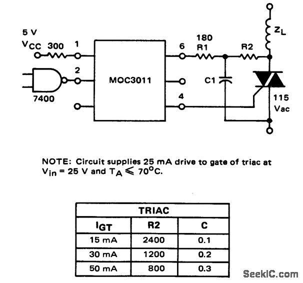

  1. wow! nice! i was going to do the same exact thing with the electrical box! except i only had one MOC and Triac from some old electronic junk, so im limited to one strand.
  2. Using a Triac would definitely be quieter than hearing the clicks of the relays. I probably will make one with Triacs and experiment with fading using pulse width modulation. A SCR would also work well.

  4. And one more thing to Conner…you can’t use PWM on ac to dim the lights, you need to detect zero cross, wait a bit, then turn triacs on. There’s many ways to do it.
      1. forgot to say above, once you have a ZC MOC with a TRIAC, just use a Arduino fade example and your done; fading Christmas lights!
