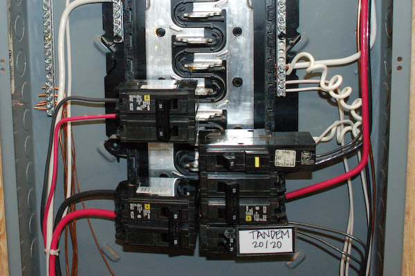

Your whole house is 240VAC. Standard outlets in the USA just use one hot, and a neutral that get you 120VAC though. But between the hots it is single phase 240VAC
Look at this picture
http://www.icreatables.com/images/electricalimgs/electrical-breaker-wire-routing.jpg
This is what a breaker service panel looks like with the cover panel off of it. See how the silver conductor bars in the middle look kind of like interlaced fingers? Each side is a hot of the 240VAC feed. A single pole breaker only connects to one finger. A double pole breaker hooks up to a finger from each side. Single pole 120VAC, double 240VAC
All the breakers on the left side are double pole 240VAC What we see on the right is more of a mixed bag though. From the top there is a single, then a double, then a double single (duplex), or two breakers running off one finger.
The other interesting feature to note is the two vertical bus bars on the outermost part of the panel. On the left we have the ground, and on the right the neutral return. Physically they are the same thing. But practically neutral return is the power path, and ground is the safety return. You should never run power through the ground on purpose either. There is a lot of code, and crap that make it how it is. Some things are better taken on faith. Let’s just say that neutral, and ground are one of them too (I don’t feel like explaining it here).
Now the mysteries of your house’s electrical system have been revealed to you! As long as you get a staple within 6 inches of a box entrance you might even pass inspection if you do any DIY electrical projects. I perform all of my own electrical stunts at home :)
