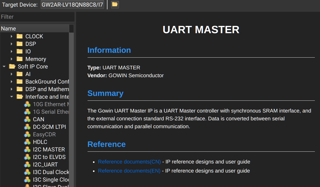

In addition, it is going to use IP — predefined blocks — to build a UART. The function is simple and contrived. By default, entering a character through the UART will echo it. However, if you push the user button on the board, it will switch the board to a mode where it adds one to the character before resending it. If you push the button again, the output will be a straight echo. When you push the button in either case, the device will send an asterisk.

The IP Generator has plenty of choices and links to documentation.

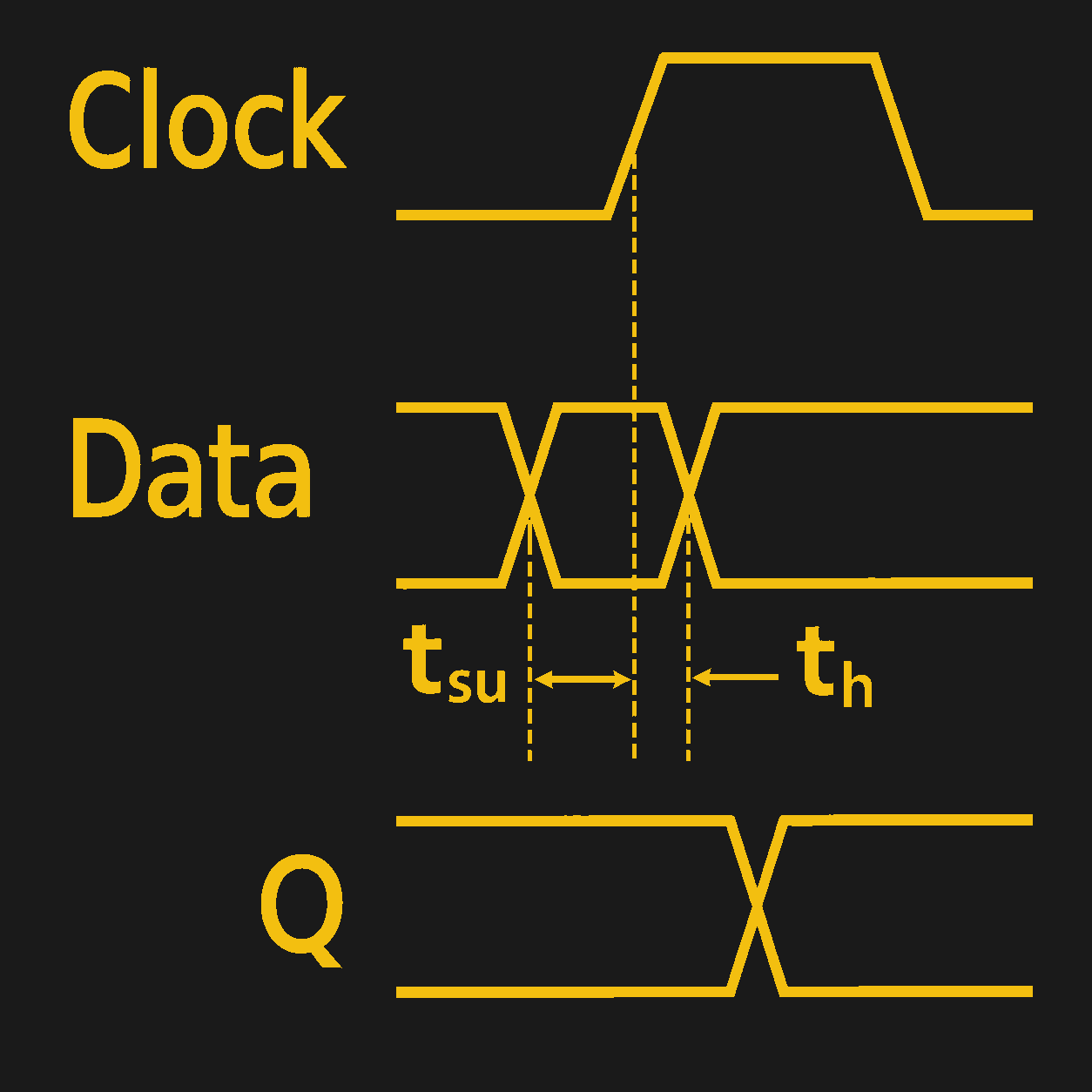

Metastability
Data must be stable for the setup time through the hold time.
I mentioned the debounce module did two things: debounces the mechanical switch and synchronizes with the clock. The problem is that we imagine flip-flops to be perfect but, of course, they are not. Any practical flip-flop has a setup time and a hold time. Imagine a very bad flip-flop that had a setup time of 100 milliseconds and a hold time of 50 milliseconds. That would mean that an input has to be stable for at least 100 milliseconds before the clock trigger and can’t change until 50 milliseconds after the trigger.
This is one thing that affects your maximum clock speed. Logic has to have time to stabilize before the clock triggers. But if something is coming from another clock or, worse still, asynchronously, then you run a risk. If the flip-flop’s requirements are not met, it can go metastable, where it could be in an indeterminate state or even oscillate wildly.
The most common way to combat this is to delay the signal with a few flip-flops. The idea is that even if one flip-flop goes metastable, it won’t go all through the system. Just something to be aware of if you deal with something asynchronous or try to connect flip-flops using one clock to those using a different clock.

  3. Btw, regarding the metastability – what Al describes in the article is a mandatory conversion of asynchronous to synchronous signal, where the “synchronous” means “synchronized with the current clock domain”. You can see this also called “registration” (which means “passed through a register”) or “reclocking” (which means “synchronized with a specific clock”), or even “glitch filters”, “debouncers” (especially with signals being input from mechanical switches), or “synchronizers”.
    What I’m trying to say – metastability of an external signal being input to a synchronous digital circuit is impossible to eliminate. But each synchronization step both reduces the probability of it, and concentrates the metastable behavior mostly inside the synchronization stage.
    Metastability is a huge issue in both ASICs and FPGAs, and basically all designs have to take some practical mitigation measures for it.
    And finally – what is metastability? It is a phenomenon, where a synchronous digital circuit (e.g. one with digital clock signal) starts to behave like crazy when subjected to an external signal with inappropriate timing. Here “crazy” means 2 basic, very nasty things:
    [1] – The digital circuit stops reacting to external signal and clock events.
    [2] – The digital circuit creates a random, erratic series of glitch pulses.
    The duration of these is random, but there are statistical models describing it. The basic explanation is: the more time the circuit is inside the metastable state, the higher the probability to exit it, but the actual time is unbounded.
