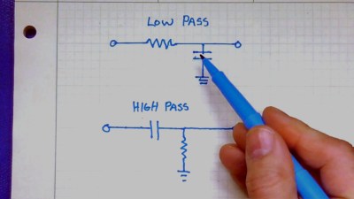

Looking into the components of a simple RC filter which can easily implement a simple Low Pass or High Pass filter, we see that the math is fairly straight forward and swapping the components with each other is all that is needed to change the type of filter.

To tell the difference between the high and low pass examine the circuit shown where the capacitor is in series with the signal. Simply put, no Direct Current (DC) can make its way through a capacitor in series, so DC (0Hz) and other low frequencies are rejected or attenuated. Likewise when the capacitor sits across the signal (from the signal to ground) it can act like a battery; it stores energy and resists a change in voltage allowing slower, lower changes or frequencies to get through while resisting faster changes in voltage.
