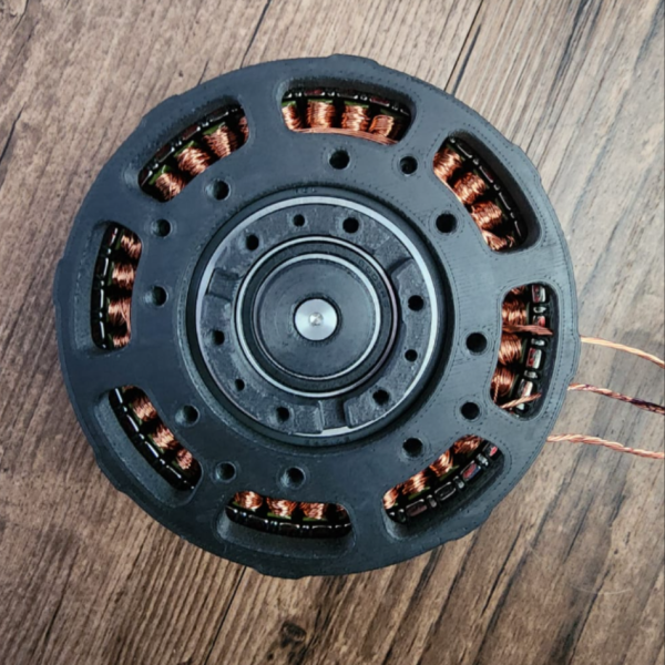

The actuator [Caden] built is a quasi-direct-drive actuator, which combines a brushless DC motor with an integrated gearbox in a small, efficient package. [Caden] wanted all of the custom parts in the motor to be 3D printed, so a backing iron for the permanent magnets was out of the question. Instead, he arranged the magnets to form a Halbach array; according to his simulations, this gave almost identical performance to a motor with a backing iron. As a side benefit, this reduced the inertia of the rotor and let it reverse more easily.
To increase torque, [Caden] used a planetary gearbox with cycloidal gear profiles, which may be the stars of the show here. These reduced backlash, decreased stress concentration on the teeth, and were easier to 3D print. He found a Python program to generate planetary gearbox designs, but ended up creating a fork with the ability to export 3D files. The motor’s stator was commercially-bought and hand-wound, and the finished drive integrates a cheap embedded motor controller.
To test the actuator, [Caden] attached an arm and applied perpendicular force. The actuator only failed on the first test because it was drawing more current than his power supply could provide, so he tested again with an EV battery module. This time, it provided 29.4 Nm of torque, almost three times his initial goal, without suffering any damage. [Caden] only stopped the test because it was drawing 50 A, and he thought he was getting close to the hardware’s limit. Given that he was able to build the entire actuator for less than $80, we think he’s well exceeded his goals.

  2. with this gear profile, not only is there constant contact with no backlash due to the profile, you can also see the “teeth” are more like lobes in one continuous outline, which a 3D printer can easily create. Both of these benefits make these gears seem like they should be fantastic for 3D printed gearboxes, and I am honestly surprised I haven’t seen anyone try this before.
    Oh yes they have. The reason for the involute gear profile is that the pressure point between the teeth and the forces follow the tangent of both gears throughout the rotation, which means both gears roll at a constant speed.
    With the lobed shape one of your gears will be rolling faster and slower as it meshes with the other, producing noise and vibration, because the velocity ratio between the two gears changes as the teeth roll. You can hear it from the test videos, how “crunchy” the gears sound when moving rapidly. That means they won’t have a very long life in use, and counting the motor revolutions won’t give you a precise estimate of movement.
    1. Not to mention what happens when you turn such a gear into a herringbone gear.
      Each cross-section of the gears represents a gear-pair in a different phase of meshing, and therefore a slightly different gear ratio for the pair since that is changing cyclically through the rotation.
      What happens when you have two gear pairs with slightly different ratios on the same shafts trying to turn at the same speed? They don’t mesh properly and they’ll jam.
      What happens in practice for the double helical gear is that the gears grind each other and force the plastic to conform until they develop enough slop that they can agree on a mutual speed.

          Involute gears are not the only kind of gears that can keep the angular velocity ratio constant, others also obey the fundamental law of gearing.
          1. Involute gears are standard not because they’re the only profile that maintains constant ratio (they aren’t) , but because they also have a lot of other benefits when making them with traditional machining techniques. If you’re not using traditional machining, then other profiles may in fact be superior.
          2. The fundamental law of gearing with cycloidal gears only holds at one exact center distance of the gears, which is not easily met with practical manufacturing and assembling tolerances. While in theory you can design a cycloidal gear pair that produces a constant velocity ratio, the more you get it wrong in manufacturing, the less constant the velocity ratio will be, which is to say it will always be a little bit off.

    3. I’m glad other’s mentioned the problems with moving away from involute gears, because that’s what immediately leapt into my mind. You can stick with involute gears and tweak them away from the standard 20deg pressure angle to make them more 3D printable while also getting some other benefits. I stumbled on https://www.geartechnology.com/low-loss-gears which had some very interesting and counter-to-conventional-wisdom results for high efficiency gears that also happen to work well with 3DPrinting that include;
      Use high pressure-angles like 40deg. This makes the tooth more rounded and strong.
      Use a very low transverse contact ratio like 0.6. This means you can shorten the tooth and chamfer the tips and roots making them more rounded and strong.
      Use a wider tooth face and higher helix angle for a high axial contact ratio. This brings the total contact ratio back up above the minimum recommended 1.2 and spreads the load over more teeth.
      The increased rounding and shorter teeth make these easier to 3DPrint, and 3DPrinting makes helical (and particularly herringbone) gears much easier to make than traditional machining. It’s an added bonus that these all add up to significantly more efficient gears under normal operating loads/speeds too.
      The only other point worth mentioning is for this particular use-case it is a super-low Kv motor with very low RPM, at least compared to most BLDC motors, so the lack of constant ratio with the non-involute gears might be barely noticeable. Also the “jamming” effect from using them in helical gears would translate into low backlash (after they wear in enough to work), which probably matters more than efficiency for this application.
