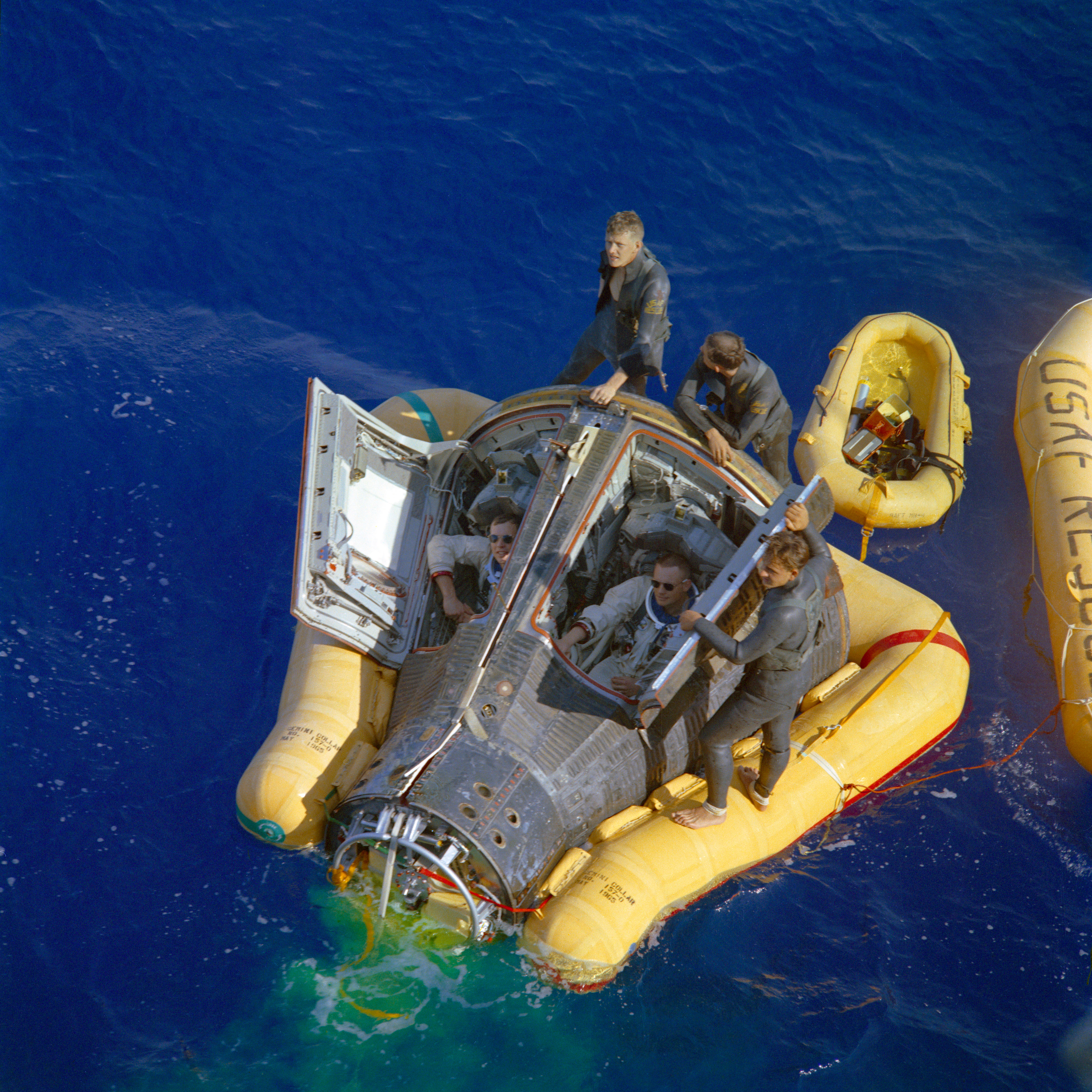

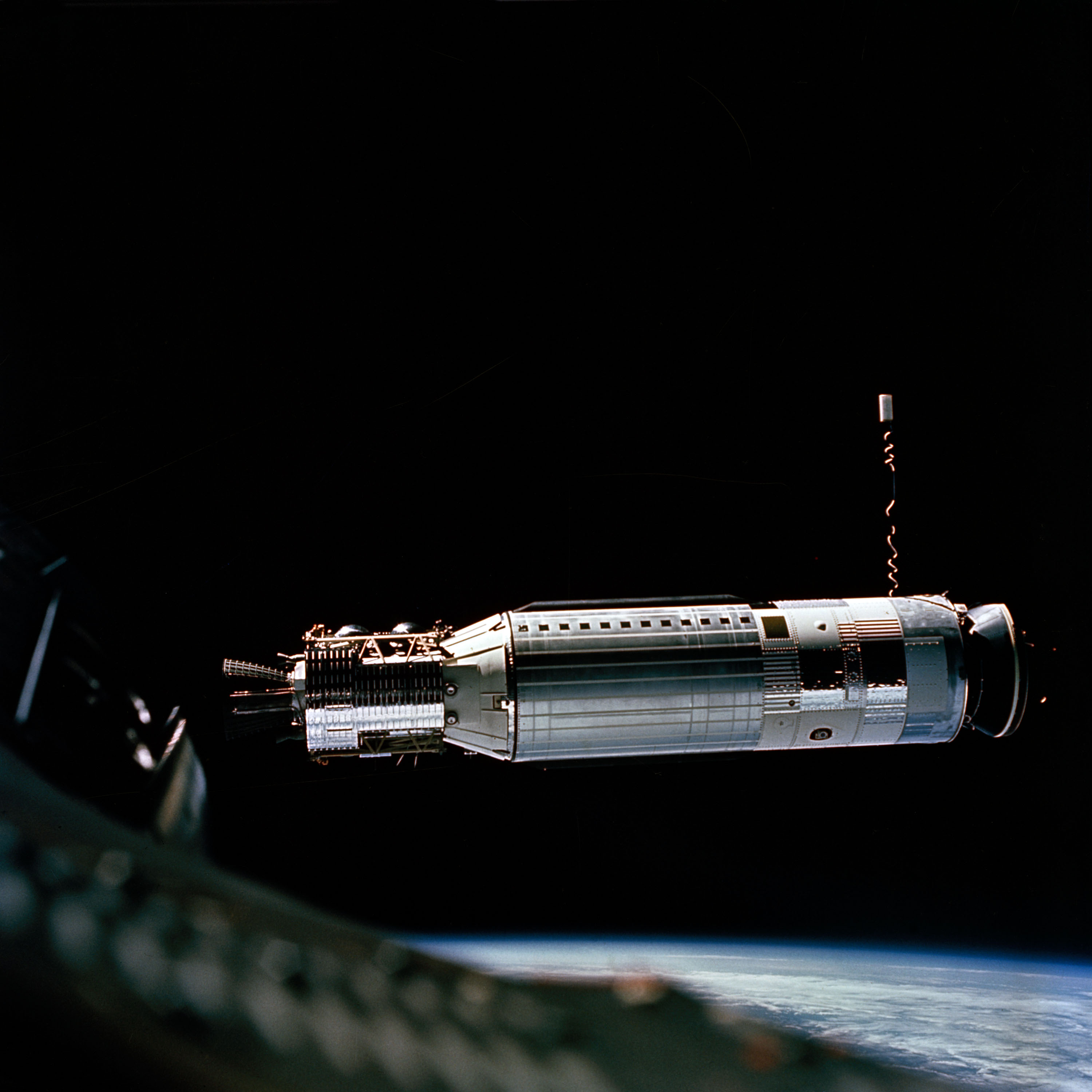

Gemini 8 and the stuck thruster
You’ve probably heard of the stuck thruster incident during Gemini 8. One of the maneuvering thrusters stuck-open, causing the spacecraft to rotate faster and faster and faster again. So fast that David and Neil Armstrong were starting to black out. They survived it by shutting down the one thruster system and using the reentry thrusters to stop the spin.
The mission had to be ended sooner than expected. Re-entry began over Africa which was not the original plan. During re-entry they passed over the Himalayas and soon thereafter landed the south China sea. David told us that the view of the Himalayas was absolutely amazing.
David and Neil were not totally confident that they had made it over ocean which necessary for a normal landing. Fortunately Neil was able to confirm this with his mirror looking out the window, seeing ocean through the window. Chutes opened and there was no need to eject over land!
