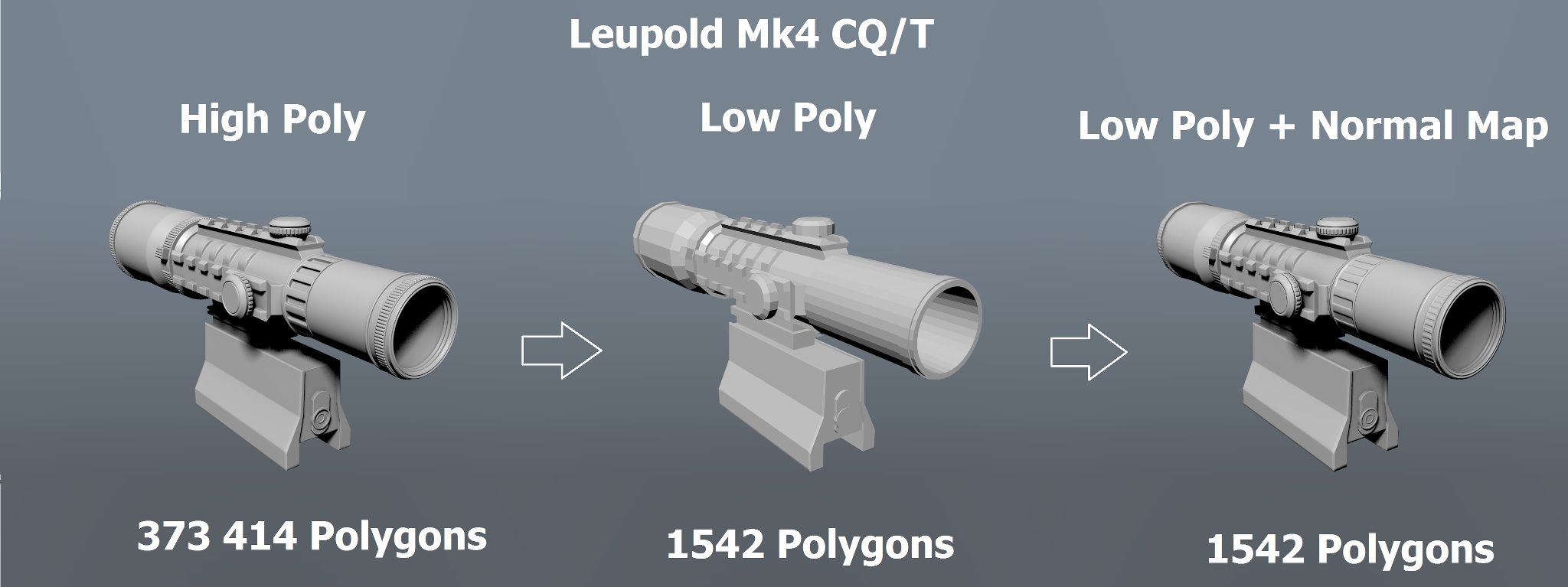

To make props from 3D video games, why not take inspiration from the original model itself? [Angus Deveson] did just that in his model-ripping tutorial using Milkshape 3D to convert the uncommon game file format into a familiar 3DS or STL format ready for 3D printing. Its worth mentioning that the raw 3D file stored in your video game may be a less-than-sufficient starting point, however. As [Stormleader] on the RPF forums explains, the 3D rendering trick known as “normal-mapping” enables video game developers to combine a low-resolution 3D model with a high-resolution texture that enhances the perceived level of detail without relying on the original high-resolution model.
normal_mapping
Image Credit: The RPF Forums
The net result is that 3D models included in the game start at an inherently low resolution–possibly too low for a detailed replica. Nevertheless a low-res model may be sufficient for a foldable Pepakura (papercraft) model.
