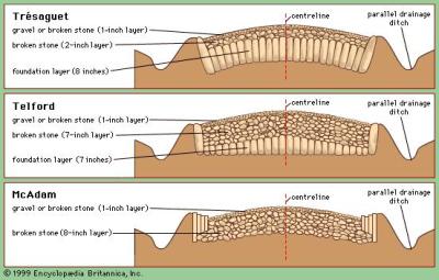

tresaguet-telford-mcadam
Evolution of the modern road. Image souce: Encyclopaedia Britannica
Trésaguet proposed that roads be built with a course of thick stones laid on their edges at the bottom of a crowned trench. These vertical foundation stones would be pounded together to ensure a tight fit. A two-inch layer of broken stones sat atop the large foundation stones, followed by an inch-thick layer of gravel.

The biggest paradigm shift since the Roman systems of roads began with John Loudon McAdam, another Scottish road builder. His legacy lives on in the “macadam” roads of today.
McAdam looked for cheaper methods that required less labor. He believed that the thick stone foundations of Roman engineering were completely unnecessary, and was certain that the issues of load support and drainage could be addressed with a bed of sharp-edged broken stones packed together.
