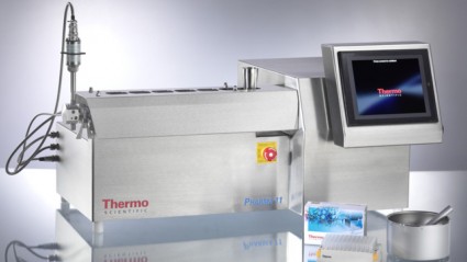

        1. Pressure sensors for extruders are not an easy thing to build: I spent a lot of time playing with one of these http://www.masterlabsrl.it/wp-content/uploads/2012/11/pharma-11-image-425×239.jpg and they have a pressure sensor on the hot end which is such a lump it makes designing an efficient die a real pain.We did a lot of hunting to try to find a small pressure sensor that could survive in the conditions and not be a random number generator, we had zero success.

    1. You’re going to have to contend with the noise from changes in the feedstock velocity as well as temperature variations. The actual different in pressure from the filament alone will be negligible.
